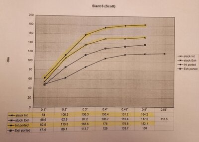

This is a flow chart made of the slant six head that one of my racing buddies had done some work on. I believe it is a drool tube style head and he had set it up for street use, not all out performance. These figures were taken at 28" and was done at a machine shop in Newport News Virginia.
It's a little difficult to tell in the picture, but from top to bottom you have Ported intake, stock intake, ported exhaust, then stock exhaust at the bottom.

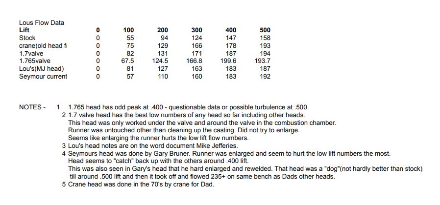

Here is some of what I found.
I think these are Doug's plots.

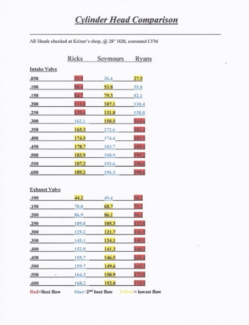

Here is our 3 tested on the same machine on the same cylinder at 28"
Ryan's had been professionally done with 7mm valves. Mine was one of the last ones Mike did. Seymour's was the one on the car when Ryan got it from him.

Rick, notice that Mikes head had the best intake flow of the three heads at the lower valve lifts.
I remember Mike saying that he was willing to give up flow at the largest valve openings to get more flow across the total intake duration. It’s what is called ‘area under the curve’. Remember the valve only sees the max lift once, it sees the other lift openings twice, once on the way open and once on the way closed.
The way the numbers look on the MJ head I bet those are 30 degree intake seats.

Yes my head does have the 30 degree intake valve

Flow benches are like weather vanes, they give direction, but by them selves don’t tell the whole story.
Rick when Ryan went from Seymour’s head to the professionally ported head did he at the same time make a lot of other car/engine changes or did he just swap on the new head? If there were no other changes it would be interesting to know how the head swap affected strip times. Maybe use a Hp calculator to see what the Hp change was.
If Ryan did make other changes maybe at some point in time you could swap his or even the Seymor head on to your Valiant, minimizing any other changes and see how strip times and calculated Hp are affected. The correlation between flow and Hp would be interesting.

I am 99% Ryan's new engine used the same cam as was in the car before. Bottom end was .085 over just like my engine. I think the compression ration is 13.4 instead of whatever Seymour was running. But the car went from a best on 11.40's to and 11.00 in the quarter. That is a lot when you are going that fast already.
I would like to see flow data on a head that only has Engine builder valves and a home port job.
