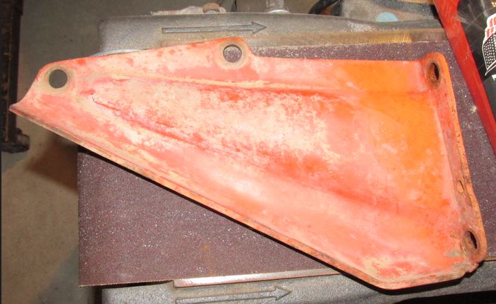

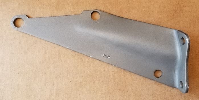

There are 2 braces, not sure what is the application difference.
One is much smaller than the other.
Top one is for automatic trans
Bottom one is for stick trans

Posts: 2755
Thanks Charrlie.
