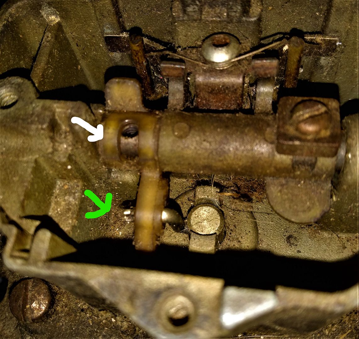

| Author: | matv91 [ Mon Jun 12, 2023 7:23 pm ] |
| Post subject: | Re: BBD carb knowledge needed |
| Author: | matv91 [ Mon Jun 12, 2023 7:32 pm ] |
white adjustment slot.green s bend bottom is smooth top has retainment shape. Sound like acc pump cup sticking is bore.Accelerator shaft should move instanely no slack no delays. |

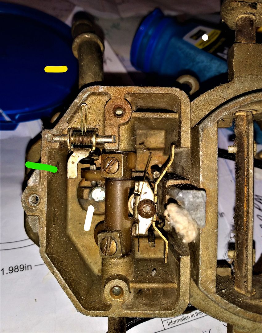

| Author: | matv91 [ Mon Jun 12, 2023 7:43 pm ] |
Does your bbd have bowl vent,they can hang up there if adjusted wrong |

| Author: | tattoosteve99 [ Mon Jun 12, 2023 9:10 pm ] |
Quote: white adjustment slot.green s bend bottom is smooth top has retainment shape. Sound like acc pump cup sticking is bore.Accelerator shaft should move instanely no slack no delays.
If I understand you correctly. When the white moves the green moves at the same time, no slack? Mine has slack and quite a bit. I’ll try to get pics of it tomorrow. Also, can I adjust the slack out of it with the adjusting slots?
| Author: | matv91 [ Tue Jun 13, 2023 7:53 am ] |
When the white moves the green moves at the same time? Yes If the pump plunger is free to move spring force will take up slack. Slot is for height adjustment. |

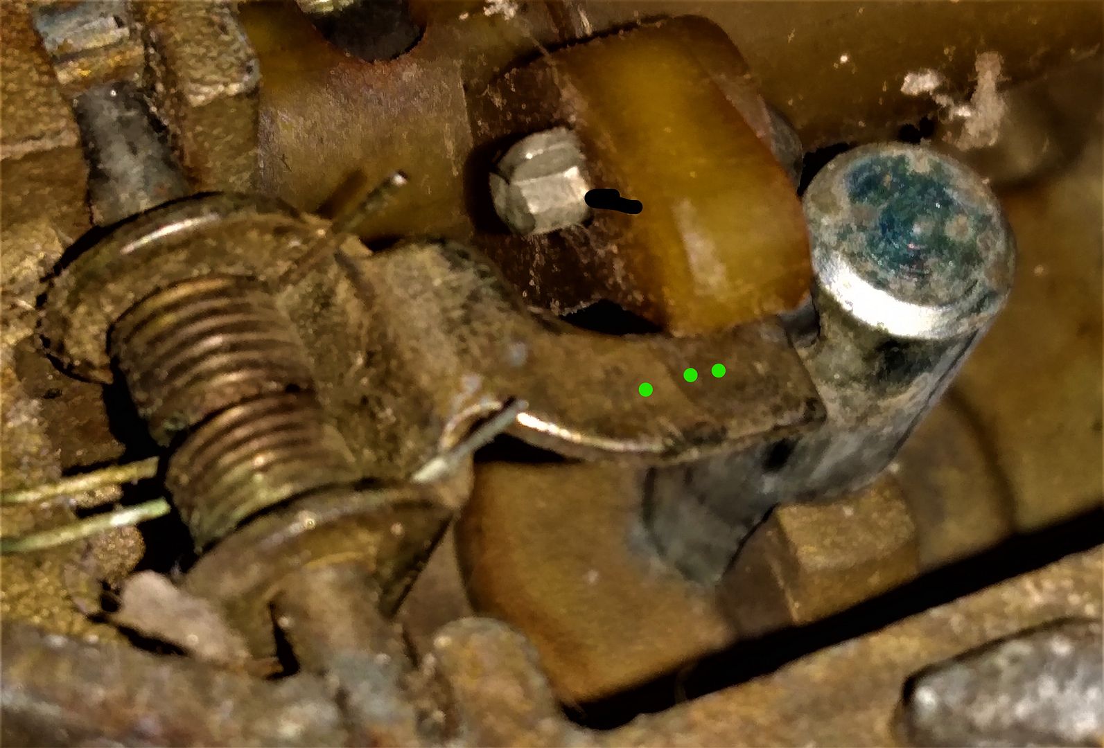

| Author: | matv91 [ Tue Jun 13, 2023 10:23 am ] |
| Author: | matv91 [ Tue Jun 13, 2023 10:37 am ] |
with bowl vent yellow vent tube Green vent control valve in correct position on top, if slips under can hang up pump shaft white top pump shaft measurement point |
| Author: | matv91 [ Tue Jun 13, 2023 11:55 am ] |
| Author: | matv91 [ Tue Jun 13, 2023 12:00 pm ] |
Green dot control valve stuck under under plastic lifting arm, that will cause trouble maybe broken lifter arm. Black points to s link in correct postion, not up side down |
