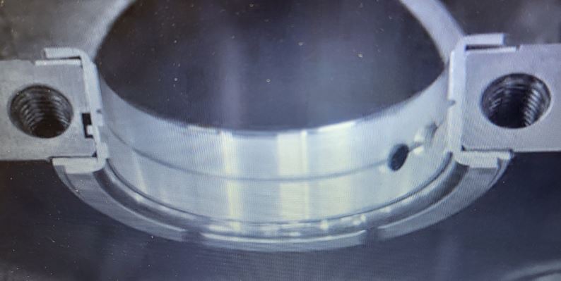

1st, please don't ask why you would want to do that questions!
The trick is 4 spacers inserted on the sides of the thrust bearing and using a forged crank thrust bearing.
Second, it looks pretty simple.
2 spacers made from aluminum, thrust bearing location, one on either side.
One .060, one .090.
They look like this, but need 4 spacers total, top and bottom.
Dave, Mark, others???

Any specific reason to make the spacers out of aluminum?
They would be easier to make in steel.

No steel is fine also.
The pictures are from youtube, they used aluminum.
I would disagree. Aluminum is much easier to turn but steel would be better.
It will cost more to make these than a crank or different block. I know you didn't ask for this info but thought I would put it out there. 30+ years of manufacturing here.
If you used steel they can be made very precisely flat and parallel on a surface grinder. That would yield a much better finished product and the machine work would be very straightforward even for an unsophisticated machine shop. It would not take any special skill or luck to make them very accurately. It would even be easy to 'adjust' the fit if it was a little too tight.
@hyper_pak - Instead of shims did you consider having the thrust surfaces on the crank welded and re-ground to fit the cast block thrust bearing?

Posts: 2615
All they have to do is locate the trust bearings in the correct location.
I like the steel idea, it's would take the trust loads better.
Thinking I didn't know what he was asking for. If it is flat I agree. My bad.
