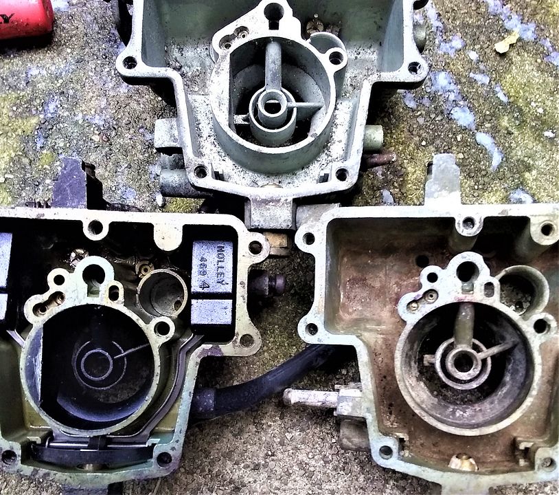

Author:  matv91 [ Sat Sep 16, 2023 11:02 am ]
Post subject:  Re: engine stalls when I rock the car (or any motion)
Image Is spring 39 float shaft retainer pushing down on 23 float hinge shaft. Top bowl screws had heli-coil, float might be shifting around a little.
Author:  matv91 [ Sat Sep 16, 2023 11:19 am ]
The float might be hanging up on side wallImage of bowl, might need to bend arm
Author:  matv91 [ Sat Sep 16, 2023 11:24 am ]
https://www.oreillyauto.com/detail/c/wa ... wlk0/10048 Brass float from walker might have better float buoyancy than plastic float. See what Dan thinks.
