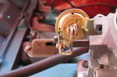

Looking for a good option for a choke thermostat on my slant that was converted over to a super six 2 barrel manifold and a carter BBD.
I am utilizing the stock 1966 exhaust manifold.
I found a picture of this setup which is similar to my setup.
Does anyone know what the part number is for this choke thermostat style?
Thank you

I got mine from eBay, from a seller called spark surplus.it was a stock part used with super 6: engines in their day
There are others (same stock replacement part) on eBay.

Save yourself a bunch of aggravation and put on a № 1232 Electric choke kit, which'll install easily, work better than the factory-type setup, and (unlike the factory item) it's adjustable.

Thanks for taking the extra steps to get me the link. I think my description I used in the search bar was too specific and I didn't get any returns. It's hard to tell from the photo that this is the correct thermostat but at second glance it looks correct. If you used this how is it wired, just 12 volt to that wire? Since my old choke was non-powered I'd have to retrofit.
No, if you're using the factory-type setup you also need the choke controller, a widget that gets bolted to the cylinder head. Ignition-on +12v to the controller, then the choke wire connects to the controller.
But the electric choke kit I linked comes complete and works better. It's not hard to adjust properly; takes—at most—two or three dead-cold starts-and-adjustments to get it just right. Can't find it…? It's right here.

Anyway is there a way to adapt the electric choke for the 1 barrel
Not even a little bit, no. The geometry of all the parts is much too different.

Ordered it this morning. Where would you say is the best spot for the sensor? Thanks for your help.
The rear of the two cylinder head bolt holes that face the sky, located between the manifolds and the valve cover, hanging over the manifolds, and with a good ground assured by removing paint and rust/dirt before installing the sensor.
