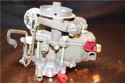

You SURE? I've seen so many people mistake a Carter BBD for a 1 barrel, I've been in more than a few arguments about this. Strangely especially on 318s which also used the BBD very much like the one on a /6 (but not identical) and the 318 never got a 1 bbl carb.... But there are people that insist that carb is a "1bbl". Just because the air intake is round and only has 1 round choke butterfly does not necessarily make it a 1 barrel.
If it is in fact a 1 barrel Carter someone has swapped them as the last /6 that came from the factory with a Carter 1bbl was about 10 years older than your truck. If that is the original carb for the truck and it is a Carter it will be a 2 barrel. Open the choke and look down it. That's where you'll see the round choke horn open up into 2 smaller barrels.
 Post subject: Re: Erratic timing
PostPosted: Sat Nov 11, 2023 11:43 am
Posts: 10430
A picture of your carb could solve this.

I cannot seem to upload pictures of the carburetor it has one Venturi and two bolts and it says Carter. If I can figure out how to upload pictures to the site I will send pictures of the carburetor
PostPosted: Tue Nov 14, 2023 1:42 pm
Posts: 1603
[img]
[/img] looks some thing like this?

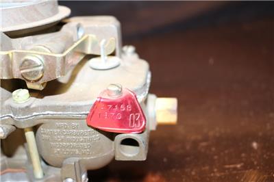

PostPosted: Tue Nov 14, 2023 1:47 pm
Posts: 1603
