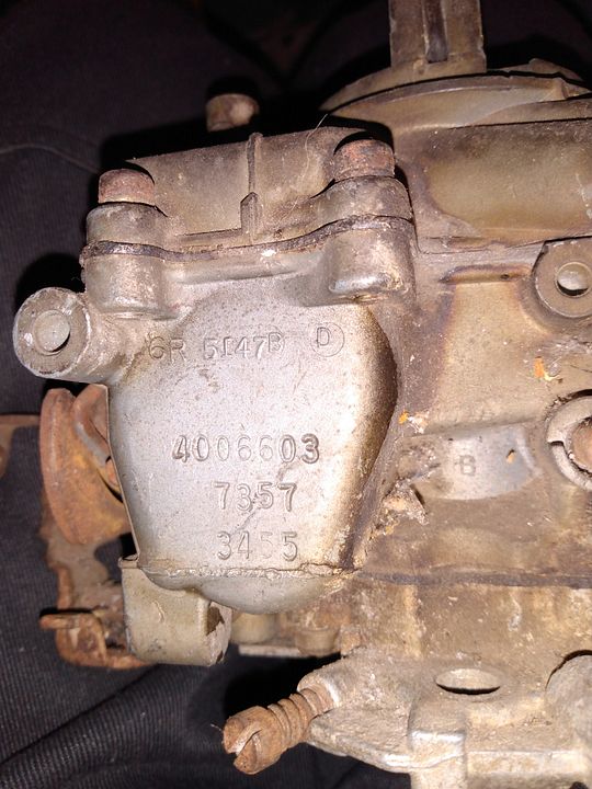

| Author: | matv91 [ Mon Dec 18, 2023 7:10 am ] |
| Post subject: | Re: Holly 1945 carburetor |

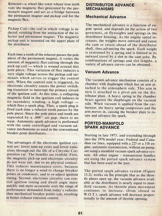

| Author: | matv91 [ Mon Dec 18, 2023 7:23 am ] |
1975 could be manifold vacuum advance,unless you have right distributor does not work very well and not under stood. more info here https://www.slantsix.org/forum/viewtopi ... =emissions |

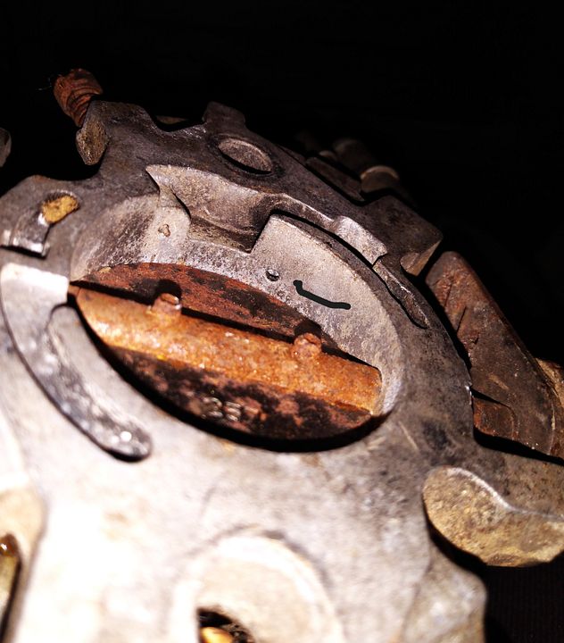

| Author: | matv91 [ Mon Dec 18, 2023 8:59 am ] |
| Author: | matv91 [ Mon Dec 18, 2023 9:01 am ] |
| Author: | matv91 [ Mon Dec 18, 2023 9:04 am ] |
That is carb 7357 black line hole to vacuum advance below throttle plate, full time vacuum to distributor not used in conventional set ups. |
