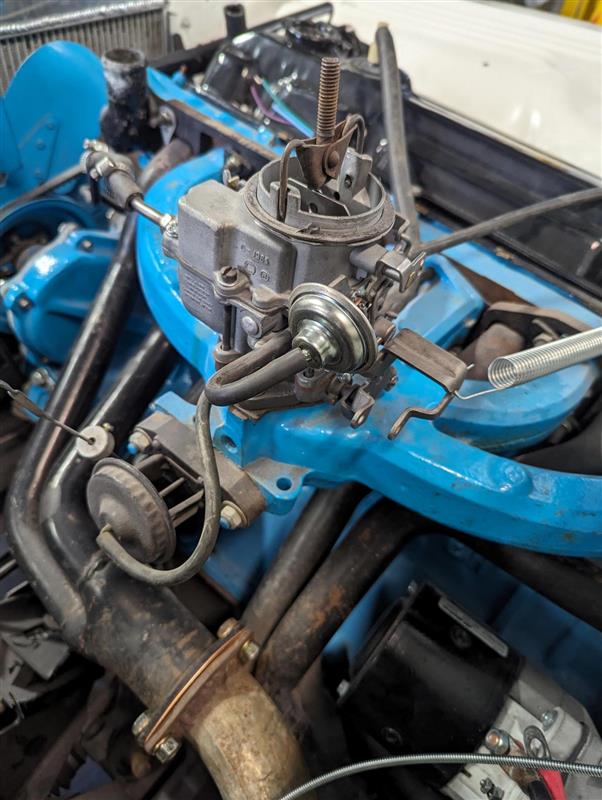

I am working on wrapping up my '70 D100 project and I've got a few missing elements.
Can anyone point me in the right direction to find the correct throttle cable bracket for a 1970 Dodge D100 - Carter Single Barrel - slant six w/ 3 speed?
Am I missing anything else?
I've attached a picture of my current setup.
Any help would be greatly appreciated.
File comment: 1970 Dodge D100 - Carter BBS - Slant Six w/ 3-speed

The throttle bracket should not be all that different from one that is intended for an automatic car/truck/van. It will have provisions for the Transmission kick-down linkage that you will not need, but other than that it should work the same by bolting near the intake/exhaust manifold sandwich area.
I probably have one if you need one. Send me a message.
