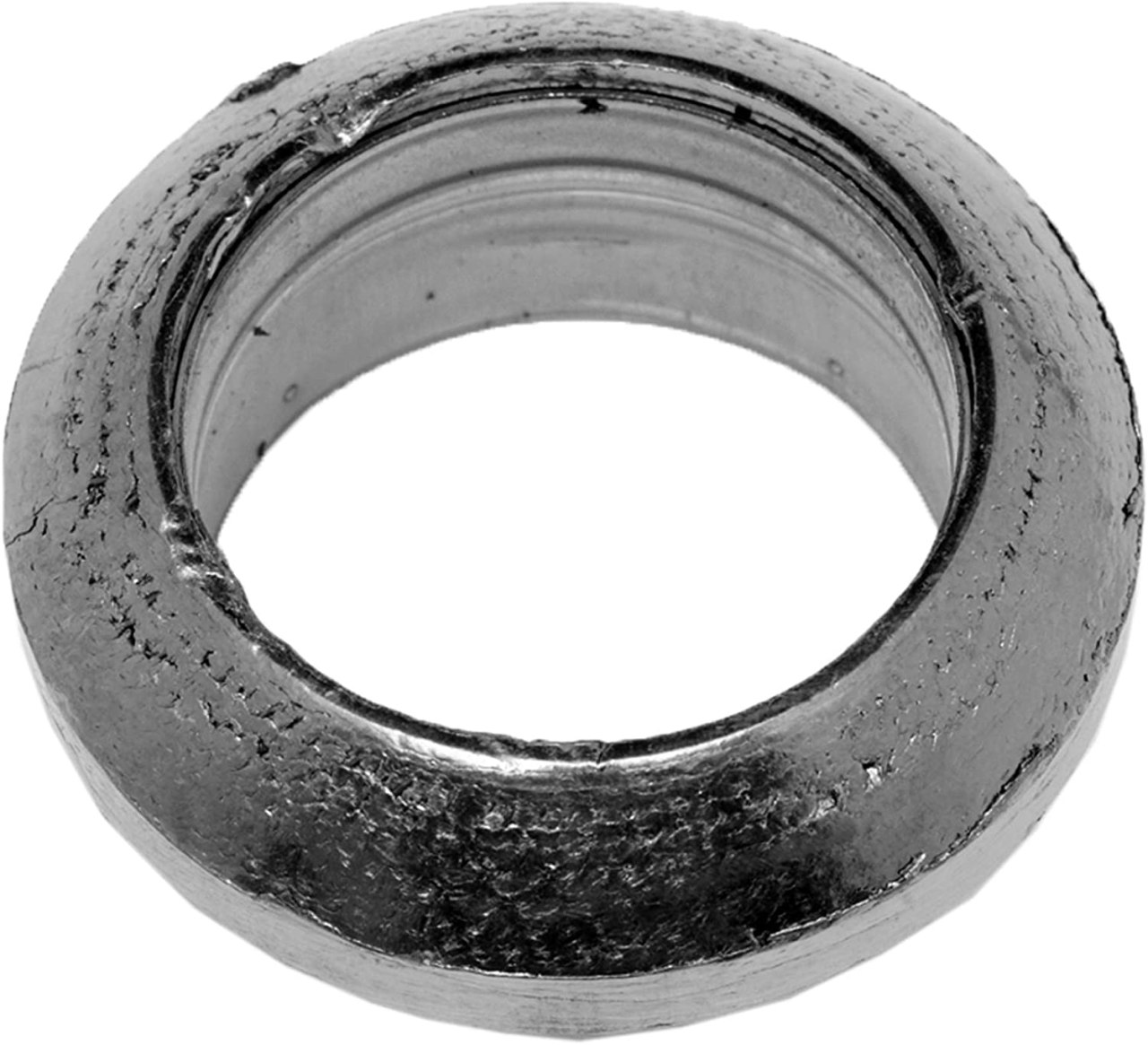

There's no donut gasket on a Slant-6. A donut gasket goes into a ball-and-socket type exhaust manifold outlet, and allows the engine to pivot relative to the headpipe. No such setup was ever built into a Slant-6, it's not found on any aftermarket manifold (maybe on some headers?), and it's not something that might be added later by an exhaust shop or anything like that. This is a donut gasket:

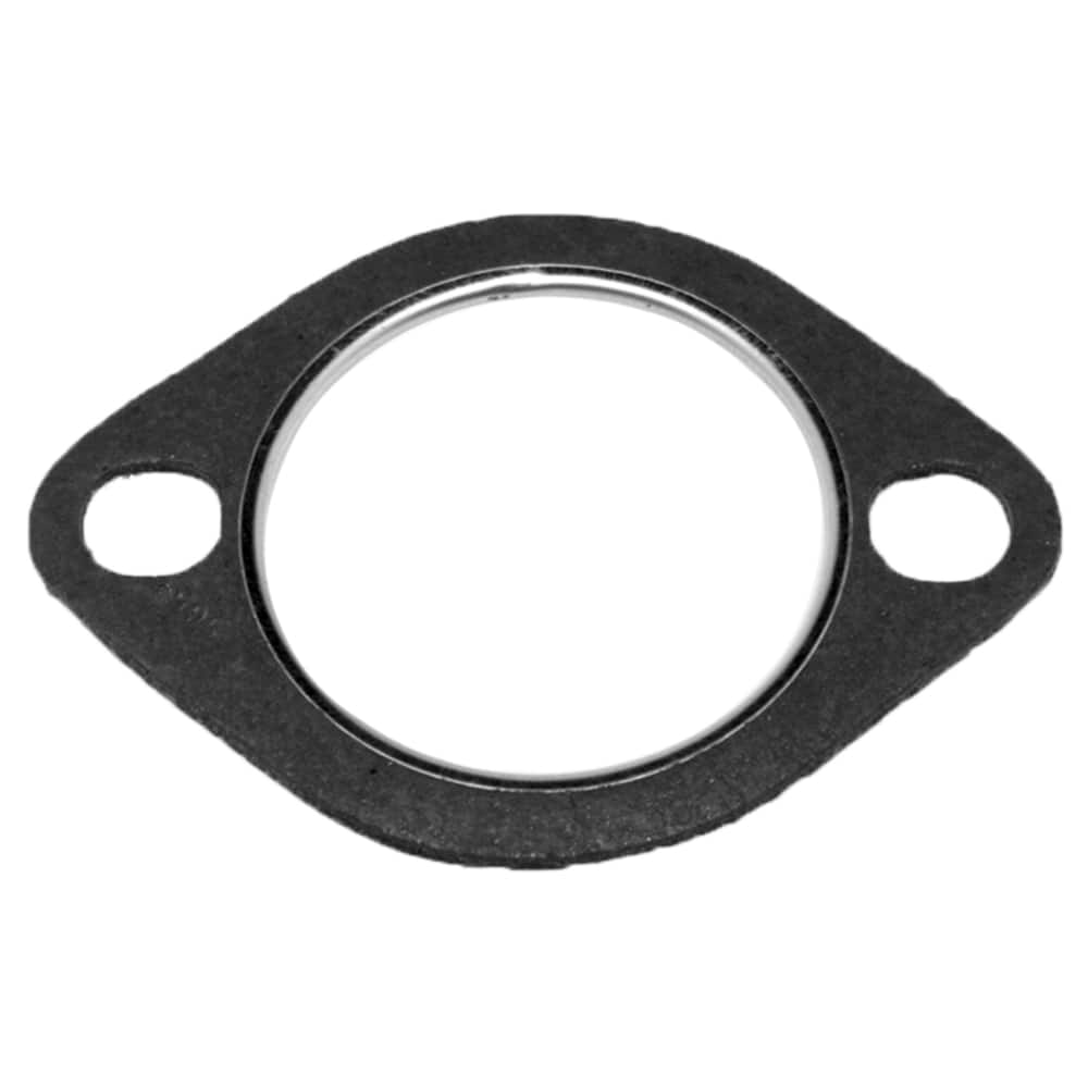

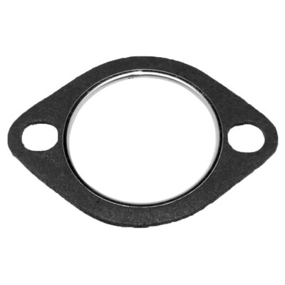

I guess you mean the exhaust manifold outlet to headpipe gasket. That's a pipe flange gasket, like this:
If that gasket is shot, replace it. That doesn't necessitate any other repair.
