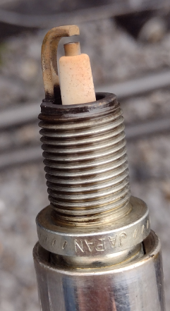

I noticed my new exhaust is blueing so I wonder if my jets are too lean or is this the right.amount of blueing. I will post a photo of that and the number 4 plug to see what y'all think. I think it's a little lean looking. White on one side and tan on the other.
 Post subject: Re: First time Racing!
PostPosted: Sat Mar 30, 2024 9:48 am
Posts: 183
Location: Southern MD
This is the same plug, number 4
