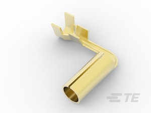

This is what I used for a 90 degree connector
https://www.te.com/en/product-60017-3.html
https://www.digikey.com/en/products/det ... 7-3/665821
TE Internal #: 60017-3
TE Internal Description: RIGHT ANGLE SHUR PLUG REC 20-16 0.41 BR
I would like to find the time to make a split mold to make a factory black insulator cover. I just used shrink tube to insulate the 90.
