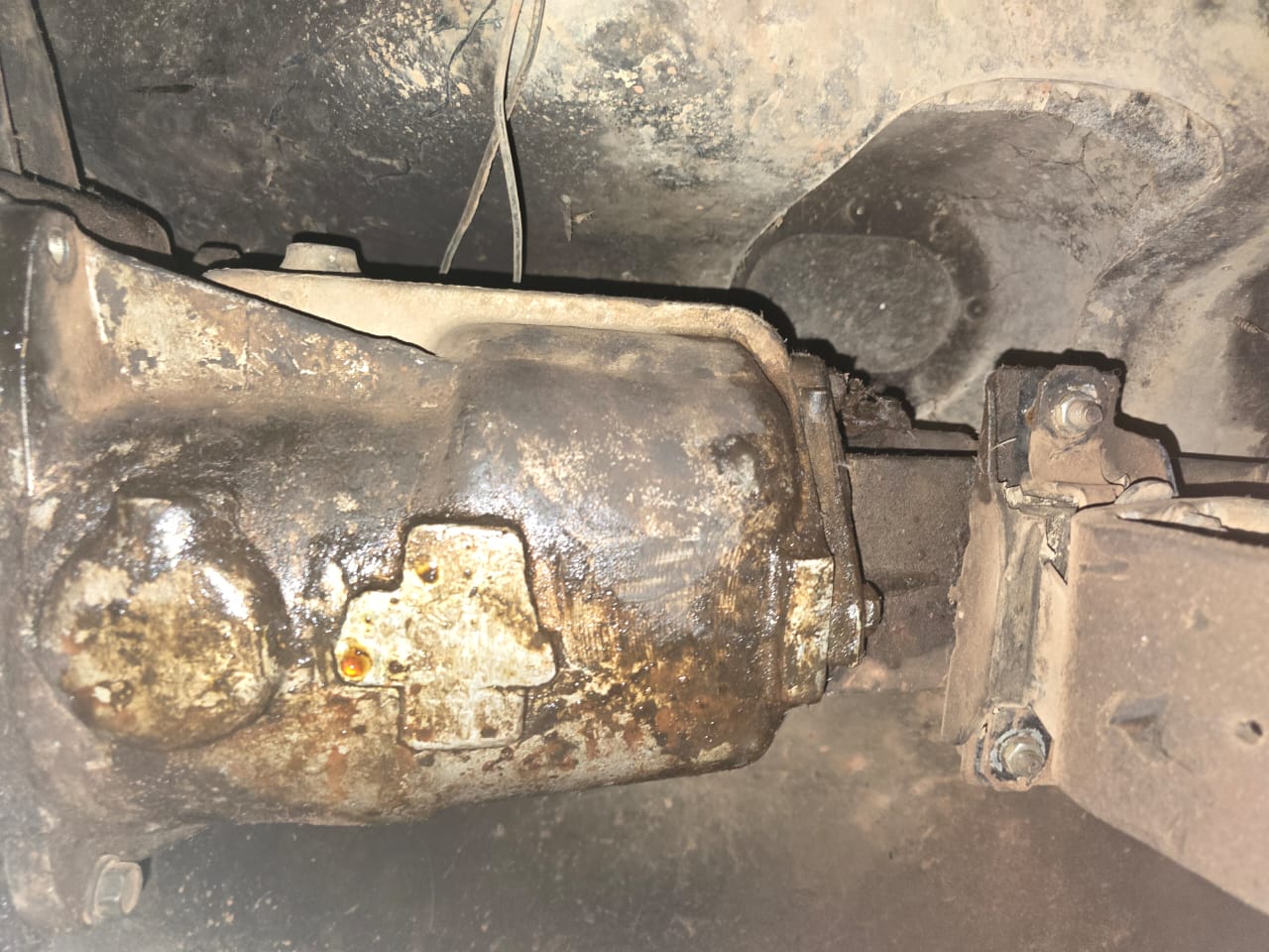

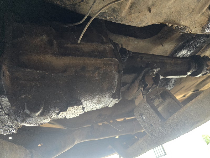

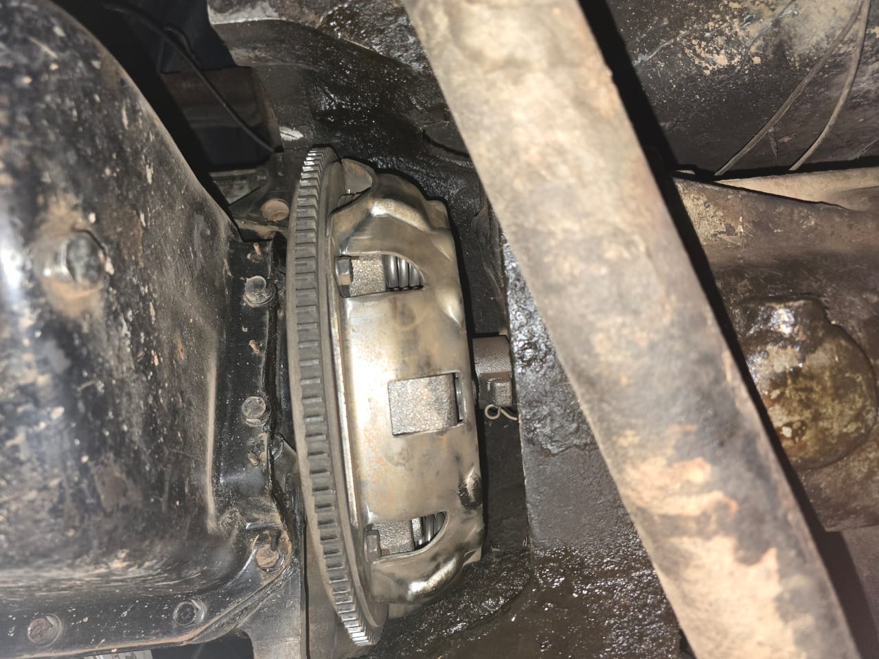

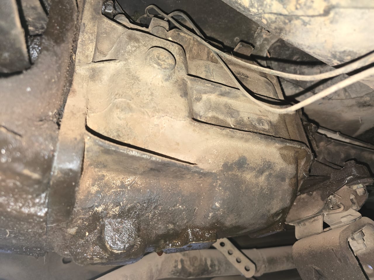

From what I can gather i have a 4 speed t-170 behind my slant six 83. They did a really bad job of doing it and I'm having issues with it. Can anyone guide me and tell me if its worth the hassle of doing it right or changing out the transmission
Number on the transmission is c-2605275

Post detailed pictures or links to high resolution pictures or a video of what you have.

This is all the pictures I have at the moment. The transmission number is c-2605275 i know it's a 4 speed and has a ford clutch.

Turns out the T170 is a Tremec 4 speed transmission used in late 70's to mid 80's Ford trucks and some cars. It is like our 833OD. 4 gears with 4th being overdrive.

It looks like a possible swap job.
The 4-speed hump for the 833 /Hurst shifter is there, s it probably had an 833 at one time.

They did a bad job at the swap
