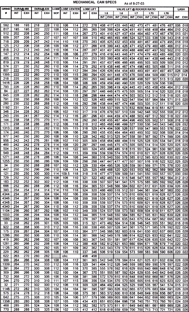

Current setup is a 72 d100, granny gear 4 speed, 3.55 gears, cast crank block, drool tube head and Super Six manifold and carb. The head has a .100" cut, chambers at 44cc, pistons are .175 below deck, doing the math I get a 9.24:1 SCR. I run 91octane, limited advance distributor and the vac pod is set really tight. Other than grinding out/ cleaning up the intake, exhaust runners, ports and chambers there is no other headwork. Unfortunately I chose the 2106 RV cam whose IVC is 31* and the cranking compression is 175psi. Doing the math again and that's an 8.3:1 DCR. The truck runs great until the revs get near 2,800 it pings and even with the timing backed off it wont rev under any load past 3K-ish. Been reading here for acceptable cams with later IVCs many of you use and have positive things to say.
The Erson 270 looks to be really popular with the medium compression crowd but I don't see an OCG grind that looks similar. Don't think I need lots of valve lift but it seems that the longer durations always come with more lift. Fortunately/ unfortunately the OCG cam chart has like 70+ grinds and there's no chance I'd be able to whittle down all of those specs into the exact cam for my truck. I have no aspirations to race, rev past 4K or have a lumpy idle, the truck doesn't tow and rarely hauls anything larger than an A motor.

Thanks for the well posed question and all the data. I’m traveling and without much time but I can work up an ocg cam for you later this week to suit you. What total mech timing advance are you running at 2800+ rpm where it is pinging?

I can certainly help with a new cam if that is what you want to do. Retarding 4 deg should have a substantial effect on cylinder pressure and thus preignition.
