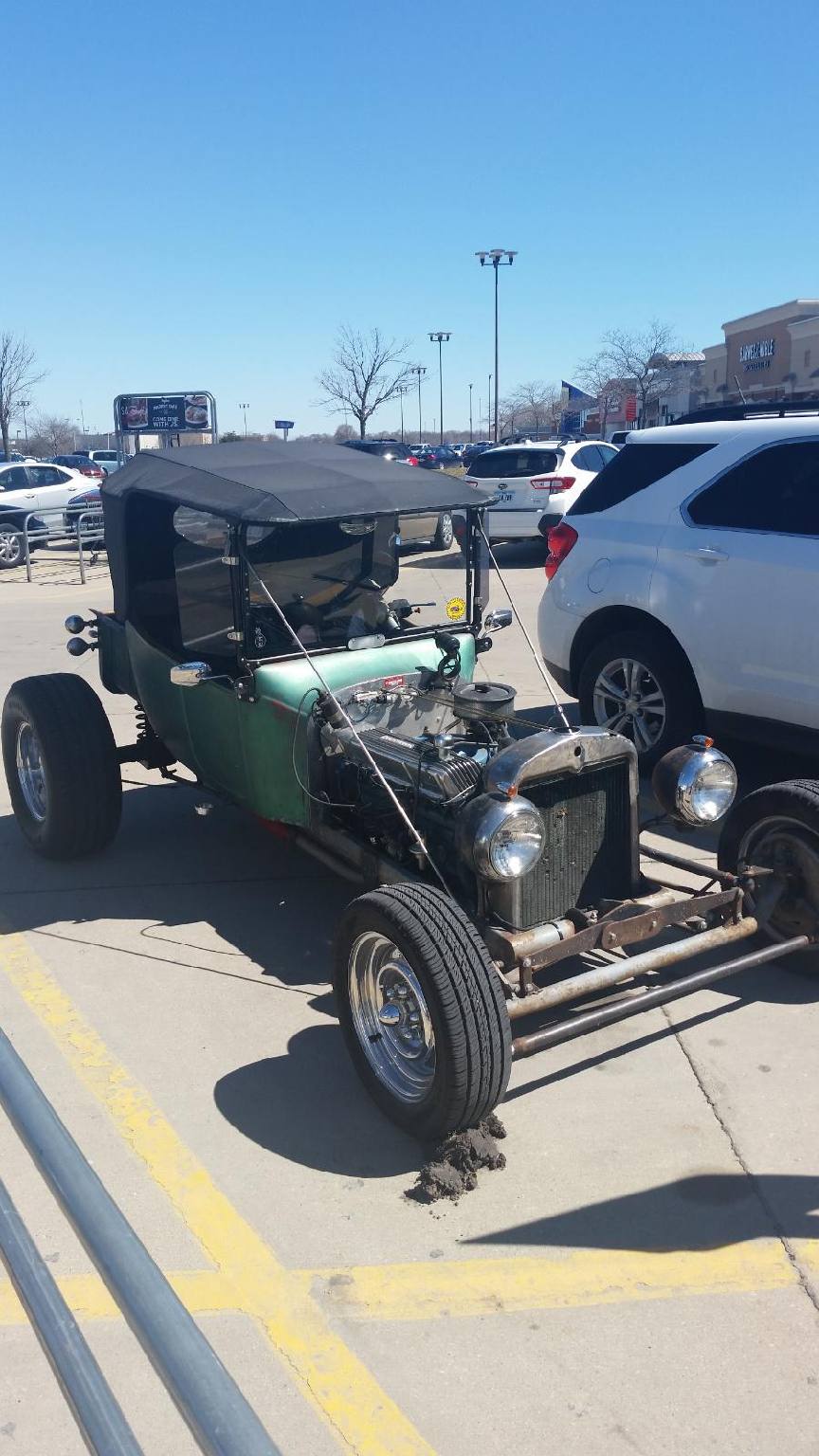

Car Model: '23 T-bucket
Watching, 'cause I plan on twin 1904's on an Offy manifold in my T-bucket. (Once I get busy and work out the vac advance arrangement.)
Roger
