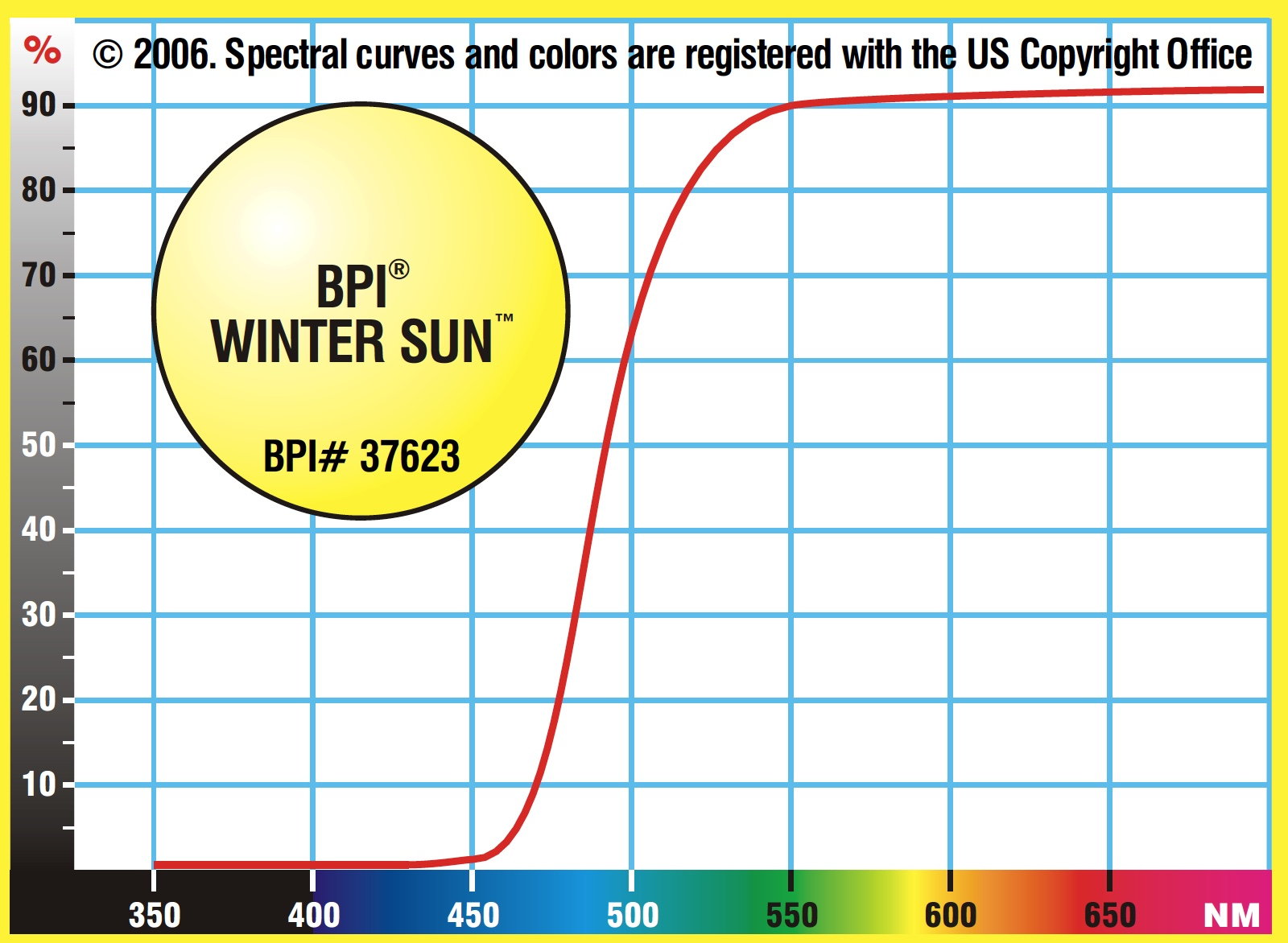

Sunglasses at night: I get that it was pretty much a joke, but people have tried this. It's a super extra bad idea, and that also goes for the overwhelming majority of the "anti-glare glasses" on the market. Just about all of them block way too much light from reaching your eyes, which is very dangerous. Any lens that's orange or amber or brownish is an automatic no. There is a way to make lenses that effectively reduce headlight glare without causing new problems, but it's not an off-the-shelf deal; it requires an optometrist able and willing to follow directions and not just sell whatever's on the shelf or in the catalogue. Costs some money, too.
Most lenses that have a visible colour to them are coloured by a dye. The exceptions are polarized sunglasses, which are inherently dark, and glass lenses, which have to be made of coloured glass. Dying the lenses requires special equipment and expertise.
BPI "Filter Vision 450/Winter Sun" is the right dye for this task. Product page is here (to direct your optometrist). Look at the transmissivity curve of a lens treated with this dye:

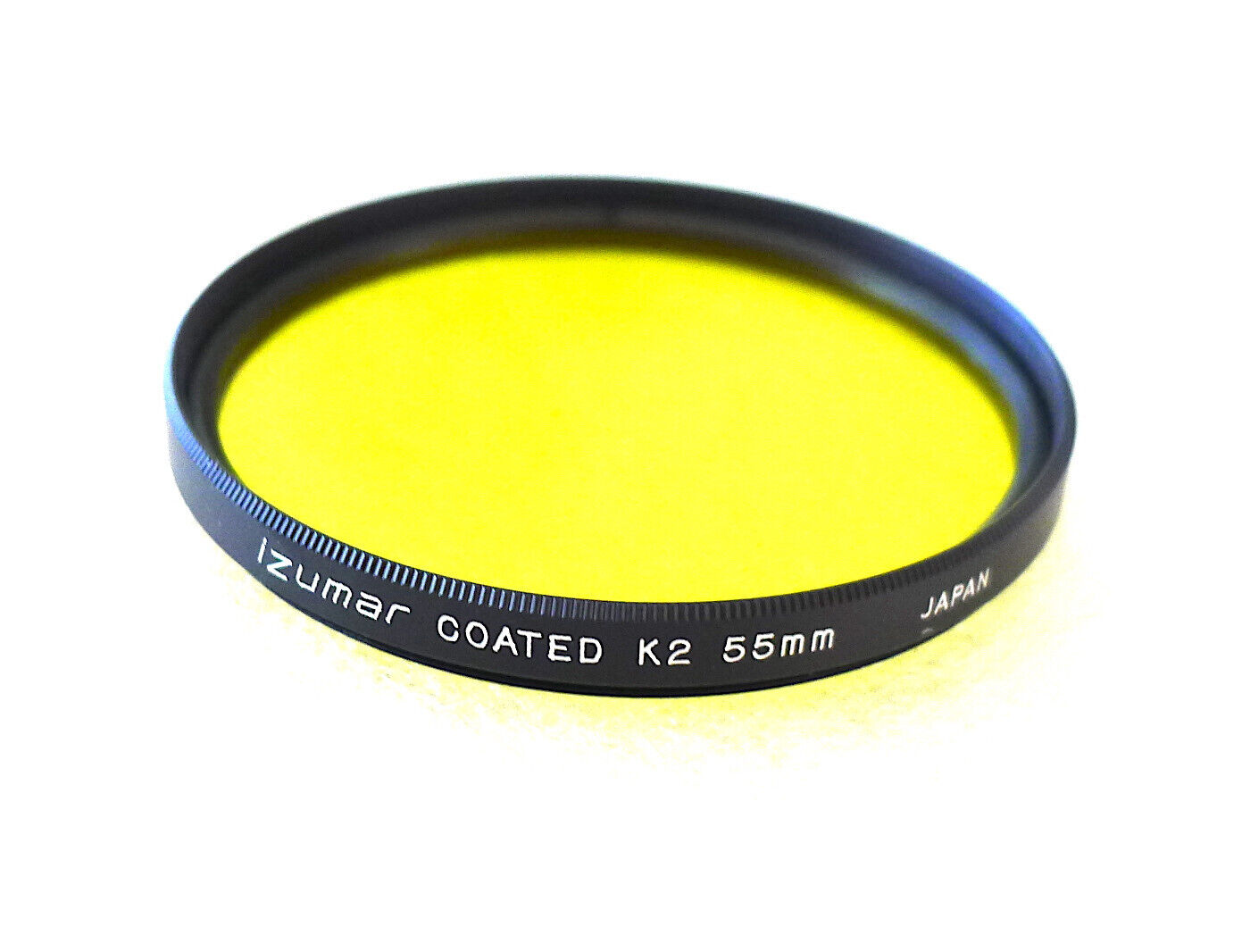

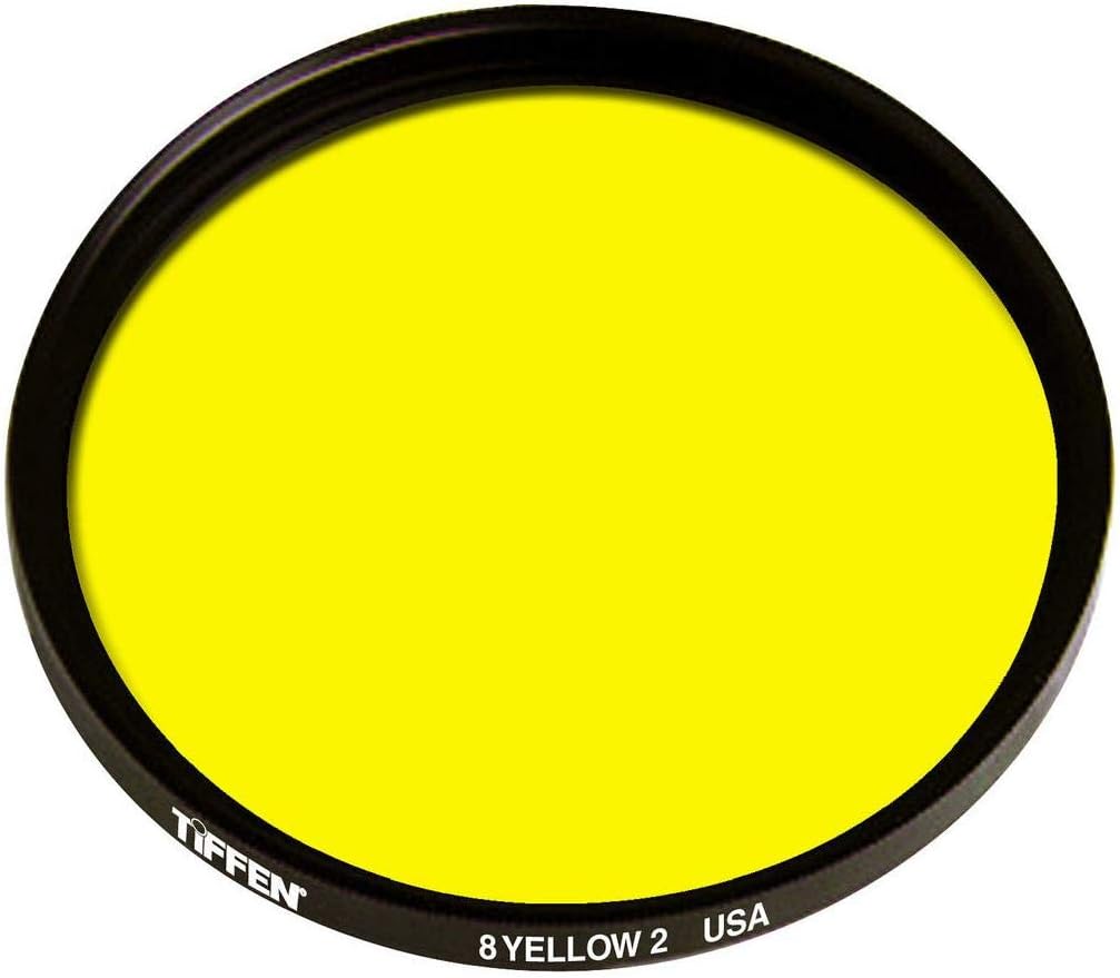

This is a "sharp cutoff" or "highly selective" filter: just about zero transmission of the blue-to-violet, and over 90 per cent transmission of green-yellow-orange-red. The result of having lenses done with this dye should look just like these camera lens filters, type "K2" or "Y2" (other designations from some makers):
See how the yellow colour is saturated, not pale, but it is yellow, not leaning at all toward orange.
