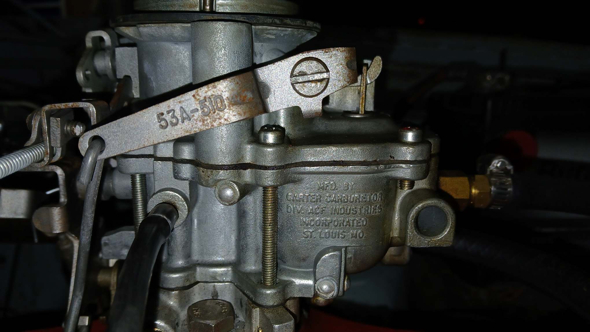

So here's the situation. I have this remanufactured BBS on my '66 225 Dart. I've put hundreds of miles on it and it seems to run pretty well other than two slight issues:
1. The exhaust always smells very rich despite any adjustments I make to the carb.
2. On hot starts, the throttle must be held wide open to start, even after short drives.
This seems to be a later BBS (I'm guessing from a '69+ truck since it has a choke cable bracket and no vacuum pulloff) I'm beginning to wonder if the bowl vent could be part of the problems. Or if it is missing parts or has just been assembled incorrectly. I've done some searching and can't seem to find another BBS with this setup. (See attachments below) They either have a "cap" that opens and closes with the accelerator pump, or a plastic vent tube on top of the bowl. So my main questions are, is this bowl vent setup correct for this era of BBS? And could an issue with this vent be attributing to my symptoms listed above? any insight would be appreciated!

4. Bowl vent looks fine to me. What do you think is wrong with it, and why do you think it's a concern?

First off: the problem you've noticed is real, not imaginary. You should not have to floor the accelerator to start the engine, except very occasionally under specific circumstances.
The cause of the problem—at least one of the causes—is there is no external bowl vent on your carb. There's meant to be a round metal disk atop the carburetor casting, with a slot through which the accelerator pump stem passes. There are three grooves on the stem. A hairpin clip is installed on one of the grooves—which one corresponds to which hole in the throttle lever contains the link to the accelerator pump lift lever—such that when the throttle closes and lifts up the stem, the disk is lifted up by the hairpin clip to provide the bowl's external vent.
Instead, the "remanufacturer" installed wrong parts—a plastic disk under the carburetor casting—such that there is never the intended atmospheric bowl vent at closed and near-closed throttle. This setup is appropriate only for '70-up California and '71-up 49-state/Canada BBS carburetors with a separate external bowl vent valve and a ducted bowl vent outlet, which your carb doesn't have.

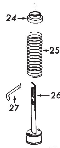

The missing disk is identified here as "Bowl vent valve":
There's a little metal bushing/hat, the bowl vent valve seat/accelerator pump spring retainer, which goes at the top of the accelerator pump spring and protrudes upward through the carb casting, to give the disk (bowl vent valve) a uniform surface to seal on (it would not do so against the uneven top of the carb casting). The bushing, identified here as 24, is Walker part № 22-53; no idea if it's still available, but from your photos it looks like that part is present on your carb, so all you'd need is the disk.
There's no aftermarket coverage of the bowl vent valve disk, but it (with that seat/retainer bushing) was used on gazillions of BBS and BBD carburetors pre-'71, so you ought to be able to scare one up.

After reading through my factory service manual and other materials on the many BBS variants, I knew my carb had some goofy things going on. Obviously the bowl vent didn't seem right to me at all. And this is indeed a manual choke carb, but it has the stepped fast idle cam for an automatic choke. It looks identical to this carb https://nationalcarburetors.com/Dodge-C ... 1336453897 Same choke lever setup with the spring and bracket. For the time being, I just have my fast idle cam/rod removed and a cable for the choke butterfly. I just operate the butterfly with the cable and use the throttle pedal for my fast idle until it warms up. Not ideal, but I rarely drive in colder weather and it rarely has trouble on cold starts. Will probably try making my own smooth fast idle cam to work with this setup.
