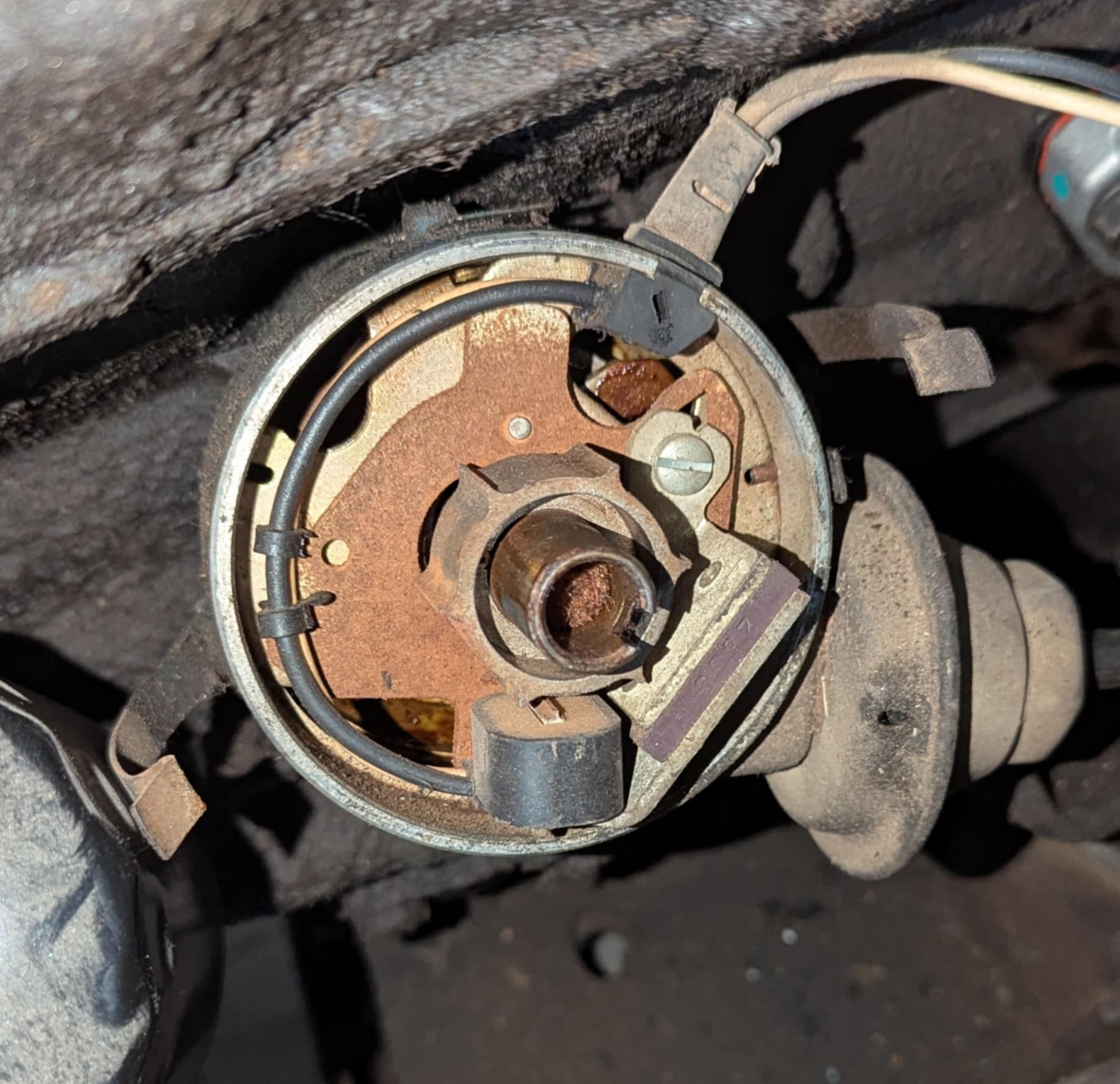

The issue persists. The pickup coil looked ugly under the distributor cap so the distributor is next on my list. (More economical to replace the whole than just the pickup coil.)
Am I going in the right direction or have I missed something more obvious?
File comment: Pickup coil under the distributor cap.

There's nothing evidently the matter with the distributor; that surface rust won't hurt anything. Pull it and lube the slide pads that enable the uppper plate to move versus the lower one, and lube the advance weights, and put the dist back in.
