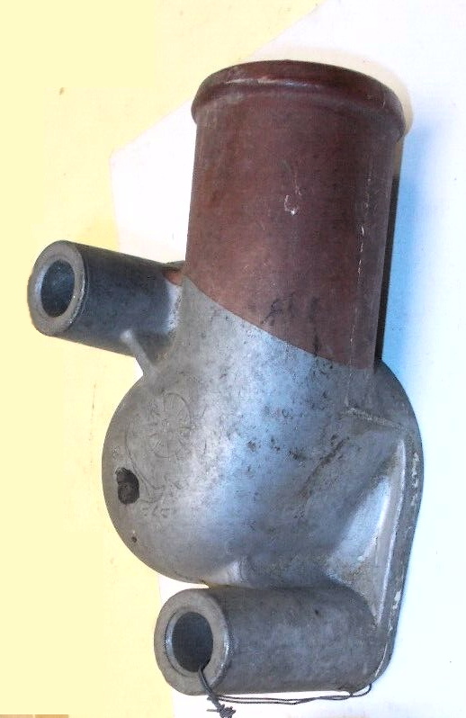

Is the high drivers side alternator a 1960 thing?
PostPosted: Thu May 29, 2025 1:16 pm
Posts: 24676
Alternator was low on the driver side unless the car had power steering, then it's high on the driver side, with a special thermostat housing 2121 908 as part of the alternator support:

I did a search for the housing and found that a few years ago.
Never seen the other bracket.
Power Steering deal?

Yes, the high drivers side alternator is as Dan said, a 1960 thing on a slant six car specifically equipped with power steering, extra long head studs going through a special cast aluminum thermostat housing, with a triangular bracket for rigidity. For 60 Valiants, only 8% of them had power steering, so it's an uncommon housing/bracket. In '61 Chrysler changed the sheet metal in the engine bay to allow the alt to be mounted in the typical place on the passenger side.
