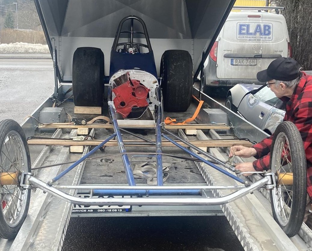

I have had E85 only slantsix about 15 years. Before that I used a mix of gasoline and E85 in a carbureted 225. The best of E85 comes out with boost. It can used like water+methanol as a cooling after turbo and probably with blower too. My Maxxecu operated engine spray up to 33% of needed fuel just after the turbo. It will drop the air pressure about 70-80 Fahrenheit degrees at 14 PSI boost.
Alcohol has high octane rating and the pinging hardly never occurs. This will be a problem as there is no warning before the engine will broke.
