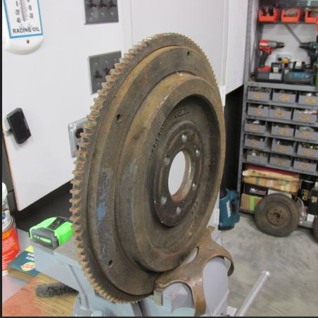

I removed the flywheel from my 76 225 Dart Sport.
There is a huge inertia ring cast into the back of the flywheel.
122 tooth flywheel with standard clutch pattern, around 10 inches.
Starter teeth are pretty chewed up, so I was going to swap with a better wheel I have.
What is the deal with the big ring flywheel?

Low Horsepower, maybe.....
Heavy Car, "It's a Lite" for crying out loud!
High Gear, 1st is a 3.09 for crying out loud!

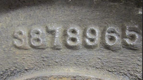

28 Lbs 3878965
VS
23 Lbs. 122 Tooth Flywheel, no inertial ring. 2128290
Ring Cast Number.

It also looks like that ring would be pretty close to the back of the block.
It was on the engine, so it fits.
Stan, that appears to be offset back, like it's for the bellhousing adapter stuff of the '70's....without using a spacer.
