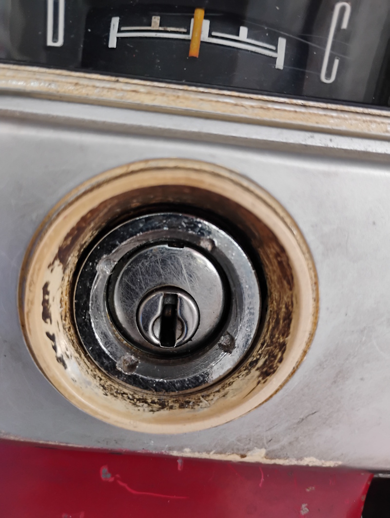

Here's the bezel it fits.
I've found it doesn't work so well on the headlight and wiper switches. I'll see about redesigning it to fit them too.

Hi Matt,
Yep, that one is different than what I had in mind!
The Headlight and wiper on my '64 and '69 are more of a rosette nut - Ign. is different on both of those as well.
