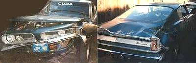

I got "hooked" on second generation Barracudas way back in college. Built a 440 powered 67 B'cuda fastback that was super fast, best time at the strip was 12.06 at 116 MPH and we would drive the car to and from the track! :shock:
Ran the wheels off this Cuda for 6 years when in 1986, after a late night "runner-up" finish and celebrations, my luck ran out and this ride met its end (I almost met my end along with the car, telephone poles don't "give" much).

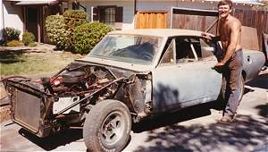

A few weeks later I dragged home a new project car. A 68 B'cuda "roller" with an 8 point cage already installed. The car also came with an 8 3/4 rear end with 4.10 gears.

Here is a post talking about work being done to get the car ready to race
Installed a "bone stock" 225 SL6 engine and 904 trans. into the roller just to get vehicle operational.
(I hate pushing cars around)
Brakes, suspension and bodywork was done "a little bit at a time" over the course of the next 4 years, progress was slow.
Building a "stroker" 170 Slant engine, I am getting "interested" in reproducing the Hyper-Pak intake manifold to use on this new engine.
The new "209" Slant engine and low first gear 904 was swapped into the "Dragcar" in the Spring of 1994

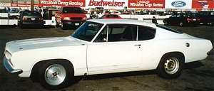

Got a great deal on a paint job so had my 68 B'cuda painted, looks much better. :)
Changed the rear end gears to 4.56 and took the car out to Sears Point to do some quarter mile runs, car ran good but the Hyper-Pak and Holley 600 gave it a little bog when I stomped it right off idle, not enough converter for the higher rear gear. I still managed to blow-off a Cramero and a 318 Dart Sport.

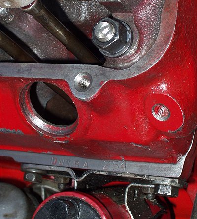

Swapped-off the "Fat-Pak" Hyper-Pak intake for a different Hyper-Pak I just casted-up. This new intake has smaller runners and a divided plenum chamber. Now the engine takes a full throttle "stomp" from idle with-out a bog.
I also scored some 4.88 gears so I need to swap those into the car.

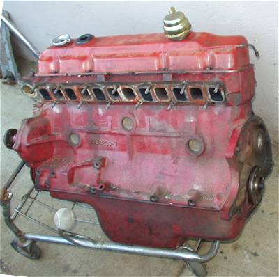

We took the pan off the 209 engine that came out of the car and found that the windage tray had come loose (broken welds) and that was banging on the crank making the knock. :o
As for the falling oil pressure, the nitride harding on the cast iron roller cam is starting to flake-off and that is tearing-up the oil pump and bearings. We will swap in a replacement flat tappet cam into this engine along with a new set of bearings and weld-up the windage tray to get it "on deck" as another back-up engine. All in all, an easy fix, everything else inside of this trick little engine looks fine.

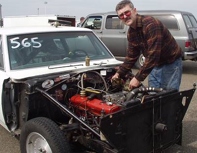

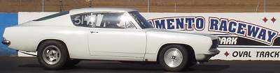

We got around to filling the NOS bottle and "shaking-out" a new Fogger II nitrous system on the SL6 Dragcar.
Bob Stepp, my son Allen and I took the car out to Sacramento raceway for Friday night Test & Tune, knowing darn well that there was a big devison 7 "Governor's Cup" race coming-up on the weekend, the place was packed & a qualifing mad-house.
Waited for hours to do the first no spray baseline pass, I got paired-up with a 66 289 "Stang" and got the best of him with a 14.63 @ 91.8 mph to his 15.31 @ 91.3 mph. He freaked-out when he stopped by to say congrats. and saw the car was a Slant powered.
We install the NOS bottle and turned the timing back to 26º total. Did a trial "burp" on a service road out at the end of the track and things were not right. Went back to the pits and found an NOS line popped-off and a few other leaks, thrashed and got it all fixed. No big deal because the tack was still working through qualifing hundreds of pro cars.
Back into line, wait and wait and wait some more. Made our second pass at 10:30 pm, got matched-up with pretty serious looking late model 5.0 Mustang. (big hood scoop, slicks, roll cage, etc.)
Knowing I was "out-gunned" and that the run was a heads-up test pass, I decided to leave on the second yellow bulb and redlighted. (.411) Hit the NOS right as the car left the start and grabbed a 60 ft. time of 1.86 to the Stang's 1.96, We gave the starting line crowd a good show by putting a couple of car llengthson that "high profile" 5.0.
Wow, the spray really made the car pull hard, it even sounded different. About 150 feet from the finish line we were past the 5500 redline and the engine laid-down. We watched the Mustang drive-by us at that point. (webmaster Chuck was in the ppassengerseat, along for the ride!) We pulled a 13.21 @ 101.4 mph to the Stang's 12.78 @ 107
The car did not miss a beat, even as we over rrevvedit through the finish. Looks like I need to find some 4.30 gears!
So we took 1.4 seconds and 10 mph off the car's time with a 80 HP "shot". See the link below for more pics of the NOS set-up.

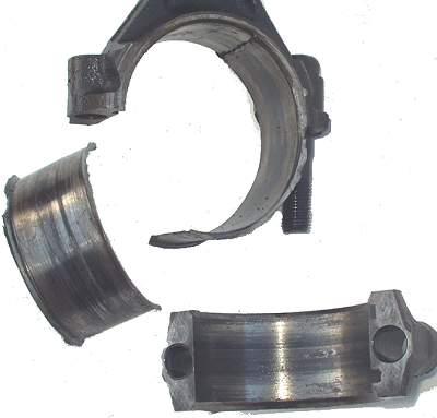

Here are some pics of the old engine comming out, 13.09 out of a junkyard shortblock then "poof"!....spun #6 rod bearing. :roll:
Seized rod bearing
http://www.dutra.org/doug/pictures/dd-cuda/swap.htm

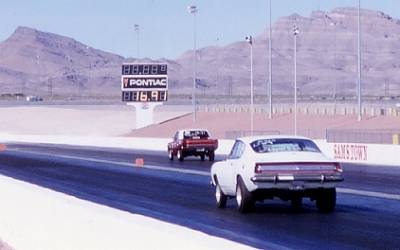

12.79 @ 103.66 mph :D :D The Cuda is now in the 12's!!
We installed colder NGK plugs and went to stagger jetting in the carb to run the front cylinders a little richer, that did the trick, no burned-off sparkplugs. The car ran a 12.96 shifting at 6000 and then ran the 12.79 shifting at 6600. I have to swap gearing from the 4.56 to 4.88 so it revs out a little better at the far end.
The 209 runs really strong with a 120 HP shot of NOS :shock:
I was hitting the NOS right at the starting line and the car was getting 1.7 - 60 ft times. Surprized a bunch of people with some great hole shots. :twisted:
So I swap gears after work tomorrow and get everything packed-up to leave for Las Vegas on Thursday, we are ready. 8)

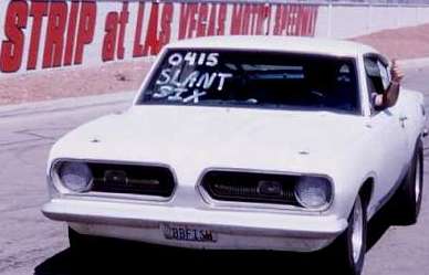

We had a great time at the "Mopars at the Strip" race.
The low block 209 did fine, all we did was change the sparkplugs after a 13.35 first pass (some popping) and just ran it. The car kept getting faster. We made a total of 11 passes, all of them with the NOS system activating right off the starting line. The best run was a 12.96 "break-out" pass to end our weekend. This was good for a club record in the NOS class.
Well, it's back to the engine stand to finish-up a 254 stroker / long rod motor and get that swapped-in for the Summer.
