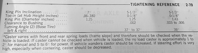

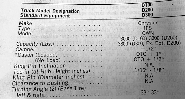

This is what the factory service manual says and the specifications I am going by:
I am reading the reference denoted by the asterix to say that the no-load caster is 1-2 degrees for manual steering truckks and 5 -6 degrees for power steering trucks. Assuming "OTO" means "zero degrees."
Unless "OTO" is a reference to the manual/power steering numbers given in the asterixed footnote. If that is the case, then for an unloaded manual steering truck, "OTO + 1/2" would be "(1-2 degrees) + 1/2", or an acceptable caster range of 1.5-2.5 degrees. Power steering would be 5.5-6.5 degrees.
THis is all moot because I think I installed the offset bushings incorectly on the driver's side. I am struggling to get even 4 degrees positive caster on the driver's side, but the passenger side has almost seven with more room to adjust. I really hope I don't have to take this all apart again. :oops:
