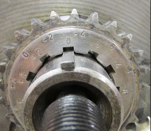

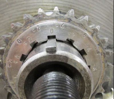

Top set of numbers is the timing mark that gets lines up with mark on cam gear that corresponds with inner circle of numbers closest to keyway you're using

And yes I looked at it and figured out the top numbers line up with the cam gear dot.
The inner number is the Advance or Retard you need.

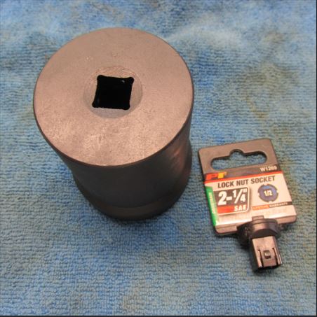

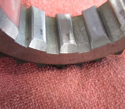

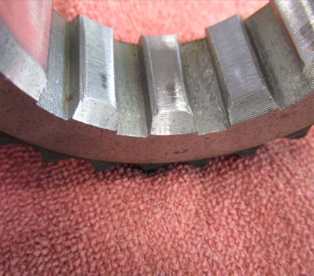

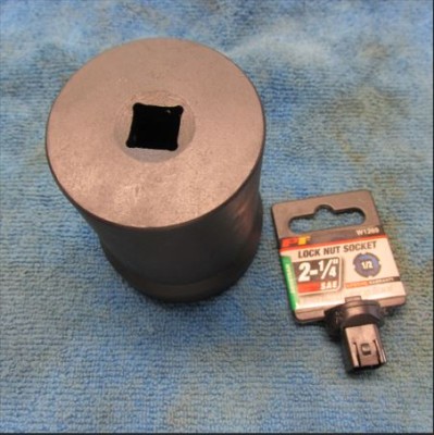

I did some measurements and it wasn't too bad.
I used a flap wheel a few times and got it to where it went on with just some light taps.
I bought a large front axle socket and it was perfect to use to tap it home.
And my 3 arm puller will pull it off without much effort.
