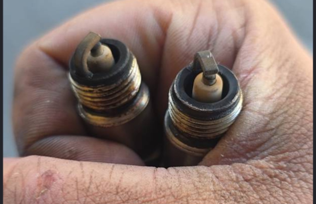

I've got a 1986 225 slant 6 with 79k on it that was blowing blue smoke after a day around town both at idle and under load. Oil pressure was dropping to 40psi at idle and up to 60psi while under load. Plugs looked okay, not wet but some carbon fouling. Took it into a shop to get the cylinders compression test done, dry test came back 105 on all 6 and they are doing a wet test in the morning.

Those spark plugs don't look bad at all, actually. I'd expect them to be much muddier if you're burning significant oil.
