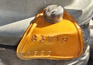

​I recently converted my Slant 6 from a 1BBL over to a 2BBL Super Six setup using a Carter BBD 8371S (date code 1822) that I rebuilt. The engine starts easily, idles smooth at ~650 RPM, and base mechanical timing is set to 10° BTDC with the vacuum line plugged.

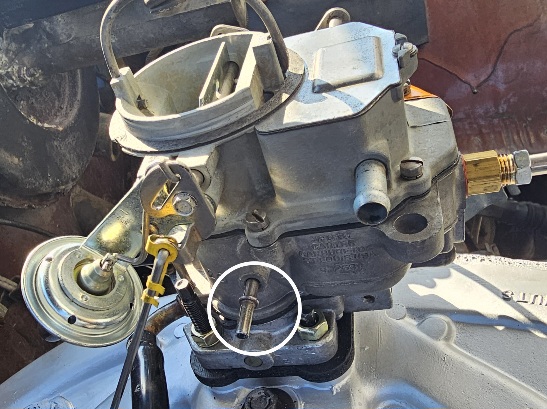

​The issue: I went to hook up distributor vacuum advance to the small vacuum nipple pointing straight out toward the passenger side, but it is pulling full manifold vacuum (15–17 in-Hg) at idle. Allegedly this is the proper port for vacuum advance.

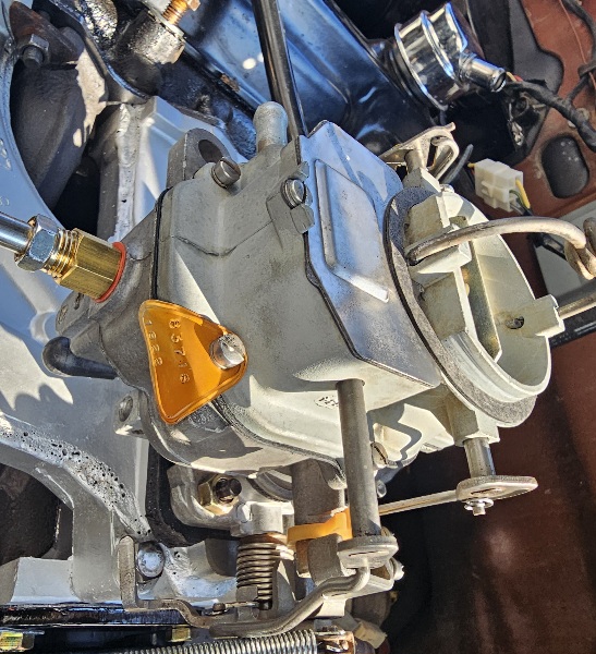

Certainly, here are some photos of it, let me know if there's a specific angle/shot that works better. The port circled in white is the port I've been understood as a vacuum advance port.

That is indeed the intended place for the hose to the distributor. On '75 and later carbs, whether that nipple gets ported or manifold vacuum depends on the transmission type (automatic, manual) and emissions package (passenger car, light-duty truck, heavy-duty truck; Federal, California, Canada) the particular carburetor is for. Here is a report on what happened when I ran a ported-vs-manifold vacuum experiment, and this thread contains ideas on how to emulated ported vacuum with a carb not equipped for it.
