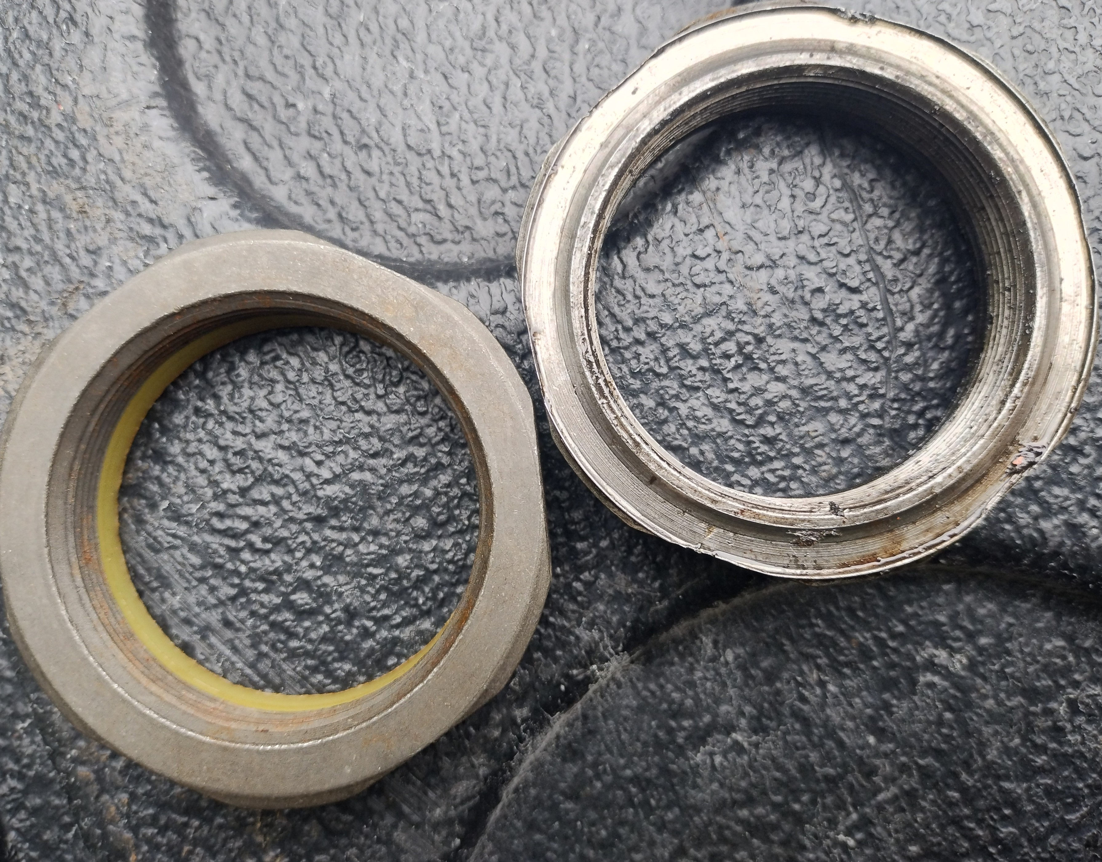

When I pulled it apart for the 2nd time I noticed that the retainer nut was quite worn where it makes contact with the inner race. I had been thinking about replacing those because of age and more likely the wedge ending up embedded in the inner nylon ring of the nut in the same spot as before (it wasn't, probably because of the wear on the nut allowing the nut to now thread in farther than before) and I went to my bolt cabinet and dug out a used one that I have had there for years.... That one wasn't worn on the back side but looked like its wedge had been taken in and out 20 places around the nut over the years... So I threw that one away and went back to eBay and ordered some more. Apparently none of the local places had them in stock anyway.

You mention in the 2nd post that the hub can move in and out. Do you mean the large full floating hub that includes the wheel studs? If it is not in the exact right place then no axle seal is going to seal it. I must be misreading the statements about the nut being worn. I don't remember any way for the adjuster nut to get worn unless something is left out or loose.

YES I inspected the sealing surface. It's perfect. It did not leak with the old seal and the play was a combo of the wear on the back of the nut and the adjustment of that nut which was actually probably loose because of the wear on the back of the retaining nut. I had it snug so there wasn't any end play when I put it back together.
$30 for 2 of these seals I don't consider "cheap" for what they are... And I think I mentioned (maybe not here I have a thread about this at 3 places right now) that comparing the actual seal lip width the ones that leak are wider And "trap" the bearing so it has no in and out play when off the rear end and laying on the ground seal side up. The seals I got from the parts store were made wrong. The next set of replacement seals fit the hub just fine but there's wiggle room for the bearing inner race like there was with the seals I first removed. The inner race would constantly be in contact with the seal lip as well as the sealing surface is. I have different seals (same part number even) and they fit more like the old ones I first took out, did. I think once I get my new hub nuts in the mailbox and put it back together with those and the 2nd set of replacement seals I think will be fine. We will see. This rear end was dry as a bone until I redid the brakes and replaced those seals the first time. And on the nuts being worn. That's something I've never seen before either. But the back face that contacts the outer bearing inner race definitely is. I'm at work now but I can get a picture of it later..

"Mcnoople" this pic is for you. Here's the wear on the back of the hub nut I was talking about vs a brand new NOS one
The drum had some in n out play before I took it apart but never leaked...
I was hoping these would be been here Saturday like USPS tracking claimed as id have been able to get it back together before our campout.. they were waiting for me today when we got home.
File comment: This is back side of hub nut. Notice the groove worn in the one vs the other.
