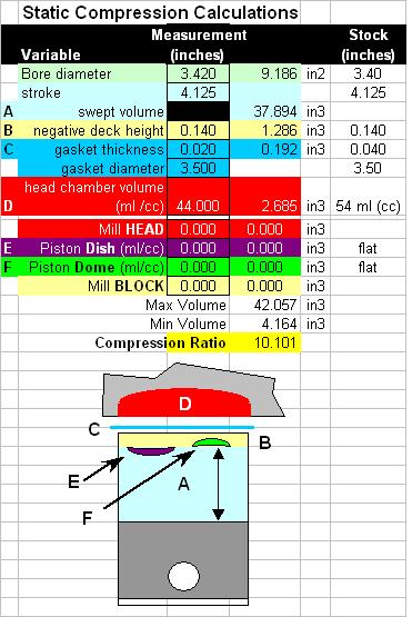

I wish I would have measured the negative deck height prior to disassembly, but I didn't. Here's the deal...
I had the block milled .100. The new pistons measure .030 shorter than the stock pistons :x
Given an estimated original negative deck height of say .145 I should have a negative deck height of .045 with the original pistons and .075 with the new pistons, right?
Well, my admittedly crude measuring device shows negative deck height of 9/64" which equates to .160 :shock:
Am I adding things wrong or measuring wrong or something? I want a true 10:1 motor when I'm done. Head cc'd at 44 cc.

Firstly Rob 9/64 = 0.140" not 0.160" so you've saved 0.020" there. According to my calculations, since you took a fair amount off the head to create the 44cc chamber, with a 0.020" head gasket, you're very close to 10. Have I missed something?

I used my cheapie Harbor Freight calipers to measure from the top of the wrist pin to the top of the piston. That gave me the difference of .030 between the stock piston and the new one.
I spoke to Doug Dutra yesterday and he said that he has seen blocks with up to .190 negative deck height. :shock:
My head porter is going to take .080 off of the head which will result in a 43.7 cc chamber. His calculations come up with 9.75:1 compression ratio with a .020 head gasket (if I can find one). If I use the composite gasket it should be 9.5:1.
Once I re-re-re-measure everything and have it all worked out I'll post something. Right now it looks like it should work out to about 230 HP and about 270 ft lbs torque.
I sure am learning more about this tuff. This is a great teaching tool to show the kids the importance of measuring things and double checking.

I borrowed a depth gauge from the machine shop last night (I had to leave my first born son) and here's the negative deck height measurements. I measured each one a dozen times at various locations and am confident that I was at TDC. I was surprised at the variance.
1 - .1390
2 - .1435
3 - .1395
4 - .1455
5 - .1430
6 - .1465
That's an overall variance of .0075
I had the crank turned .010
New .010 over crank and rod bearings that I verified tolerance with plastigauge
Deck milled .100 from whatever it was originally(next time I'm measuring first)
New cast pistons that are .030 shorter than stock pistons
So, the head was milled .080 that should equate to a 43.7 cc chamber. He is going to cc it again now that it is milled

Looks like you are on the right trail there, Rob. You should be right around 10:1.
The piston can rock in the bore some, and that will account for most or all of your variance there.

I just got off the phone with Gerald, my head porter. I had my numbers messed up. It was 47.3, not 43.7. He just cc'ed the head and it is actually a 49cc chamber after milling .080.
That should calculate to 9.544:1 CR with a .020 head gasket or
9.203:1 with the Fel Pro gasket I have.
