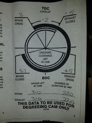

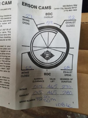

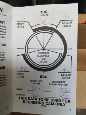

Now.....to address the request by Lou for the spec cards for my two cams.
This is what's included with the cam(s). I take it you might have a recommendation between the two?
Roger
PostPosted: Tue Jun 10, 2025 3:43 am
Posts: 17006
Thanks, Roger.
I would use the 270/270 cam. 270/280 is backwards for a 225. You want more duration on the intake than the exhaust, so that one will most probably run worse than the 270/270 or at least won't do you any good. I'm not saying you can't use the 270/280, but it is not using the valve timing curves efficiently for a 225 (large ratio of exh to intake flow, long stroke and small bore).
I would degree the cam at 100-102 deg intake centerline and I would target 9.0:1 static CR. You might go 9.5:1, but you'll be more on the edge for a street car and pump gas and will have to be more careful with ign timing. 220 @ 0.050" is not a big cam - a decent but not large step up from stock.
I have the Erson 280/270 "reverse" version in my Project V engine with 9.6:1 and it runs great for what's in that motor.
Happy building!
PostPosted: Tue Jun 10, 2025 5:31 am
Posts: 1841
Location: Waterloo, Iowa
Car Model: '23 T-bucket
Hmmmm. Interesting....those cams were bought wayyyy back when we were still using the "old" board software, and have been waiting for me. I'm pretty sure that was a grind that Doc suggested for use. I wonder if maybe the card is printed out incorrectly, and the events are actually the other way around.
Either way, many thanks for the recommendation.
Roger
PostPosted: Tue Jun 10, 2025 7:02 am
Posts: 17006
Doc and I and others have recommended more duration on INT than EXH for at least a couple of decades. They may be reversed. You might be able to tell by measuring with a caliper or you can put it into a block and run the duration and lift numbers with a dial indicator. Or maybe there are markings? I bought my 280/270 through Menko Johnson's group buy maybe 15-20 yrs ago and just put it into a motor 3 yrs ago. If you have a real 280/270 (I/E), then I would use that with 9.0-9.6:1 comp.
