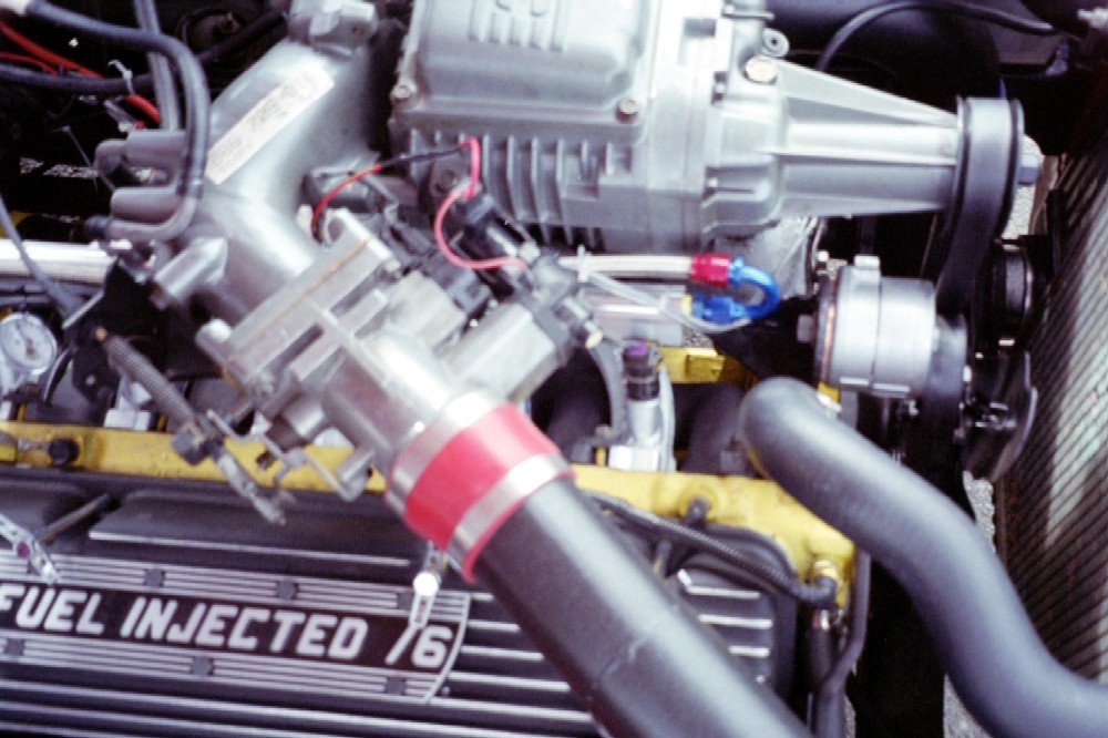

here's where I put mine - I used the front hole behind the thermostat on a 76 head
http://www.projectplato.com/cars/Images ... engbay.jpg
Cheers!
