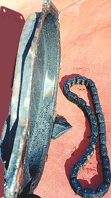

In 64 the factory was using the metal (cast iron) gears so you do not have to worry about plastic teeth breaking.
I have seen the early (metal gears) go 300K+, to the point where the chain was so streached that it rubs a hole in the T. Cover! This will run the cam timing late but the chain did not "jump teeth".
"If it's not broke, don't fix it" may apply here.
Counterpoint, you can *degree-in* your cam if you go in there to change the chain set. (put 2-4º advance on it) Doing that could find some lost power / performance, it's your call.
