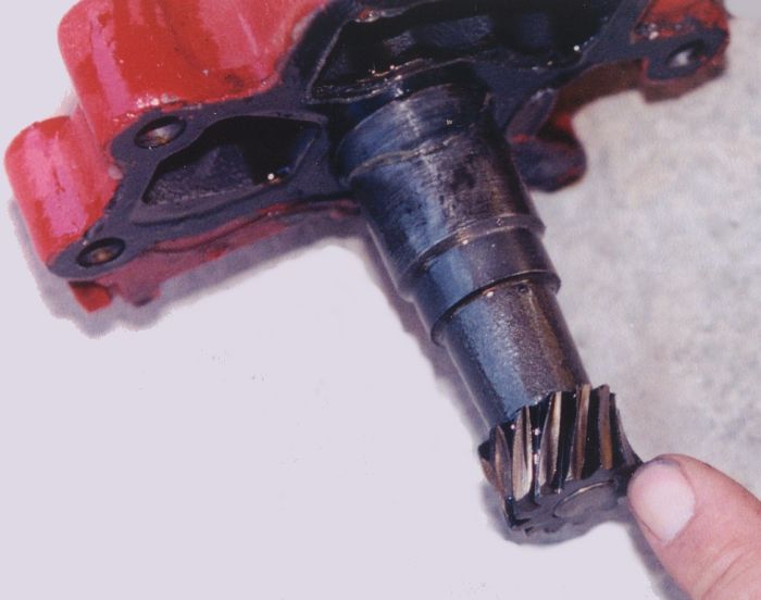

Have you checked the oil pressure with a mechanical gauge, readings as low as 15-20 psi at idle are OK with 45-55 psi after 2000 RPM expected.
Off idle pressure can be adjusted by shimming the relief valve spring but be forwarned, for some reason we are seeing many aftermarket oil pump gear failures. (the gears do not seem to be as hard as the original ones)
Keep the pressure reasonable to prevent problems.
Oil Pump Gear Failure report
