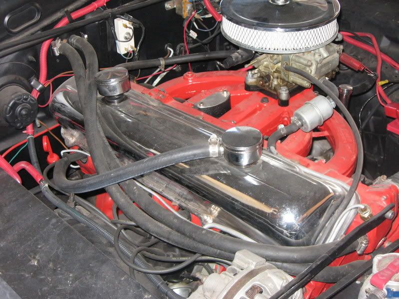

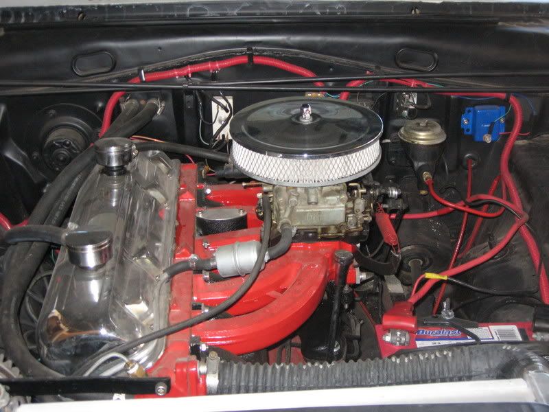

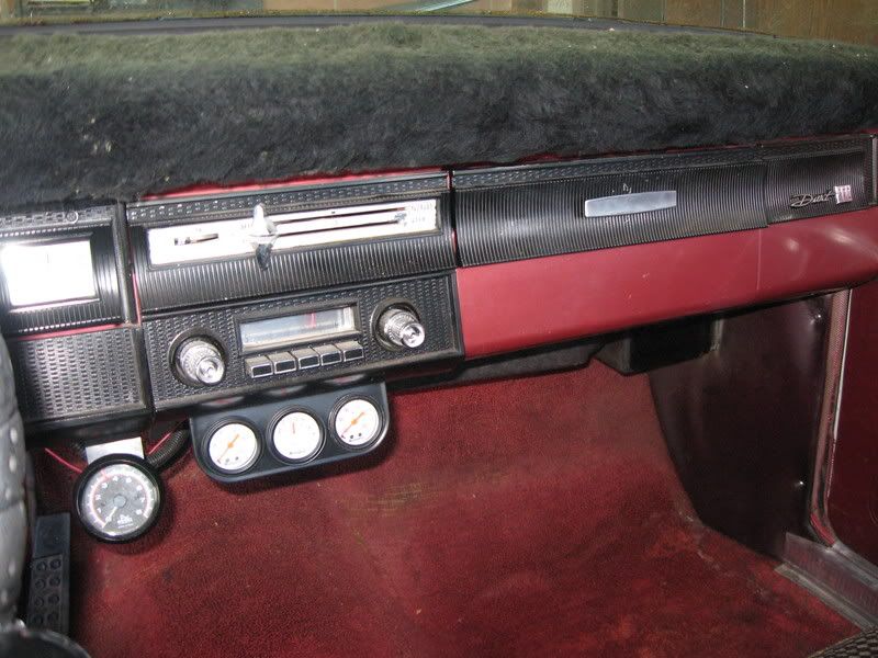

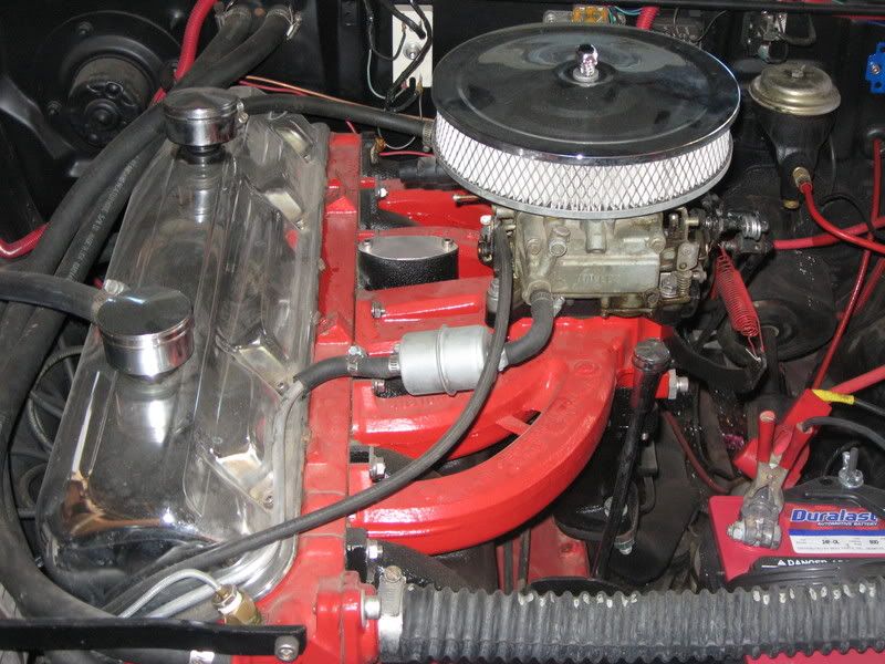

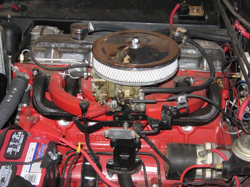

Meet Dav my '65 dart 270 all work was done by myself with help pulling the motor & dropping her back in by a buddy shes not show quality but rather pretty for my daily driver

any engine work or just a nice paint job on it? the black, red and chrome looks good together!

its a rebuilt 225 with the super 6 & a holley 2bbl ,custom throttle cable & bracket ,alum. radiator(kept over heating after i got the 2 bbl put on ) ,electronic ingntion

BTW, could you possibly send me some detailed pics on how you made the throttle cable work with the factory rods and transmission rod linkage? At some point I am sure that I will be wanting to do a 2 barrel, and I really dont want to swap out the pedal like we did on Stephanies 65 270, it was a little bit more than a pain.

we had to fabracate it the throttle cables off a 72 duster & changed out the pedal lever but kept the origanial pedal & used a ball bearing like the ones from a skate board
