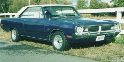

Anyway, here's my ride:
Plum Crazy Purple 71 Swinger
68 225 block and head
Bored 30 over
Head shaved 90
SBC Valves - I think they ended up 1.72I/1.50E
340 Springs
MP 268 cam
Silvolite pistons
Stock rods
Cox bros true double roller timing chain (what a thing of beauty) installed with cam advanced 2 degrees (per one of Doc's old messages)
J&M windage tray (figured I'd do it while everything was open (another thing of beauty))
Clifford 4bbl intake
Edelbrock 500cfm carb (stock jets, may need to do some playing but seems to be working okay)
Clifford street rod headers
Dual 2-1/4" pipes from header out w/ Flowmaster Delta 40's
10" Midwest verter (per Dennis' specs I think (stall around 2500)) (also a thing of beauty)
Stock 904
and finally (I hate to mention this part) stock 7-1/4 rear w/ 2.76? gears
To be done someday soon I hope:
Disc brakes (Should have done this stuff before the engine, but stopping is over-rated)
8-3/4 w/ 3.55 gears
Thanks again to all who offered me advise along the way.
Erik

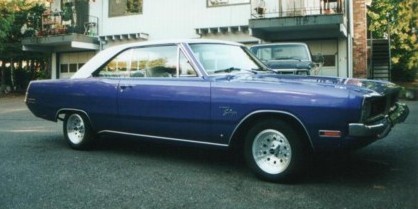

Should be before and after paint-job pictures below:

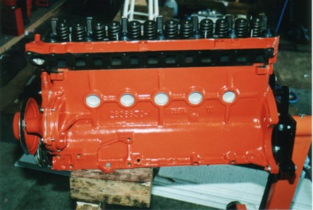

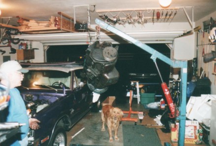

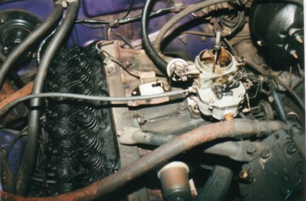

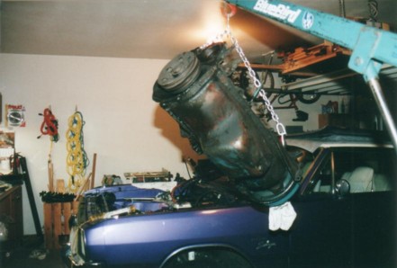

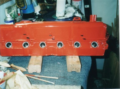

Old engine coming out...... what a mess!!! :shock: :D
Start of Removal:
It's out!!!!
My Helpers: Dad @ left, and his dog Kohtee front and center (as usual)

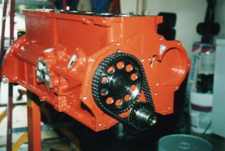

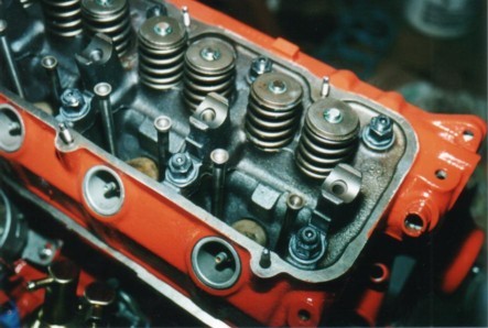

New engine going back together :D :D :twisted: . Check out my ad for the Cox Bros (3rd picture). I think it is my favorite picture of all....
Wish there was a way to leave this exposed!!!!

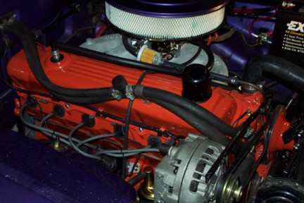

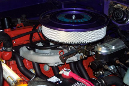

Finally...engine in the car. And amazingly, for my very first engine rebuild, everything seems to be working... :lol: :lol:

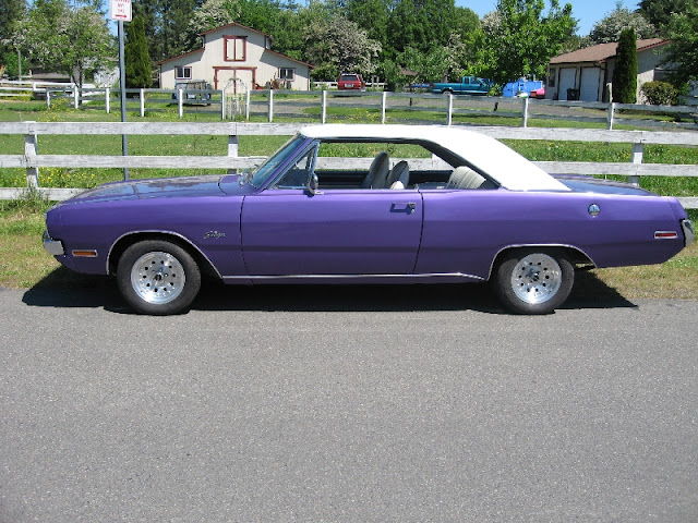

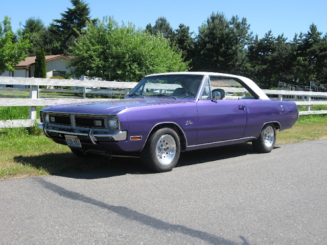

New paint, vinyl top, and seat upholstery added in 2009. Paint and vinyl top done by Rocket Restoration in Olympia. Great bunch of guys. Just wish I had enough money to cut them loose on a full resto.
Anyway, here are some updated pictures:
There's someone in my head but it's not me!!
