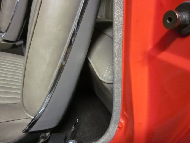

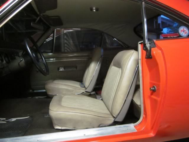

Since I'm 6'7" tall, there aren't many cars I can easily fit into, and my A-body is no exception. When I originally bought my '67 Barracuda with bucket seats, the seat foam was old and broken down, and allowed me to sit much lower. After I had new foam installed, I couldn't even sit upright in the car. This post shows how I increased both head and leg room. This simple modification has allowed me to drive my car in comfort.

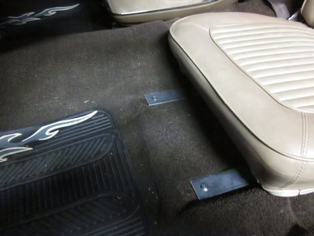

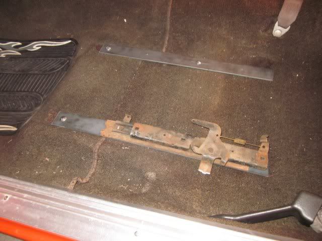

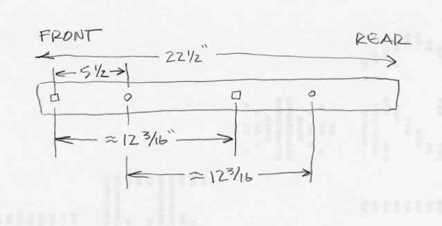

This mod requires you to fabricate two longitudinal (fore-and-aft) brackets. With the stock seat location, there was about 5-1/2" rear leg room (between the bucket seat back and the rear bench seat) in my car. The longitudinal distance between the floorboard holes on my car is about 12-3/16". For max front leg room, I want to move my seat brackets back 5-1/2". I will drill two sets of mounting holes in my longitudinal bracket:

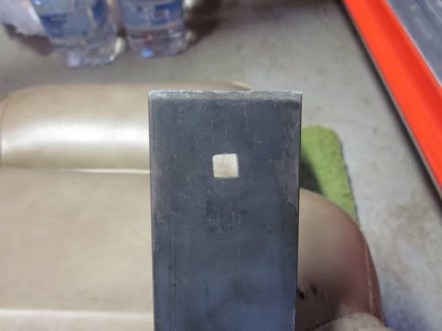

Note the front set of holes, which will attach the brackets to the floor, are square. You will want to use carriage bolts here (3/16" I think). Drill the holes a little smaller than necessary, then use a small square or triangular-shaped file to file them into the same shape and size as the square shoulder on the carriage bolts:

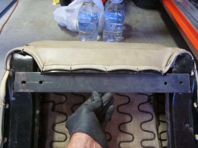

The second set of holes is drilled 5-1/2" back from the first set. These are round, and will be used to mount the bench seat tracks:
The outside bracket is shown here with a bench seat track sitting on it. If you don't need to lower your seat, you can simply attach your bucket seat track to the rear pair of holes in this bracket and you're done. Note - if you're not using bench seat tracks, you probably want to make all four holes square. That way, you can insert carriage bolts from the bottom, to attach your bucket seat track to the bracket.

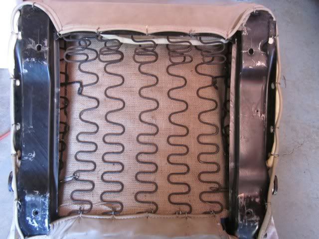

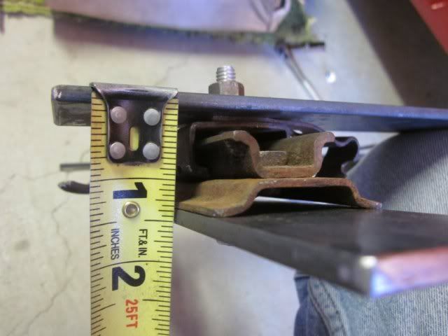

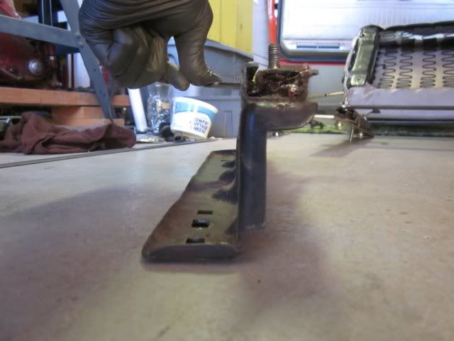

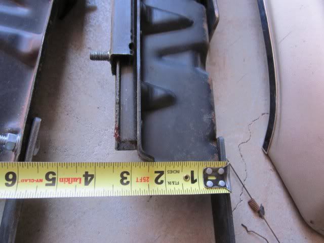

The seat brackets/tracks on my buckets are 3-1/2" tall:
Bench seat tracks are only about 1-1/2" high. By using the bench tracks, you can gain 2" of head room. I found a usable pair of 70-76 A-body bench seat tracks on eBay for only $30, plus $10 shipping:

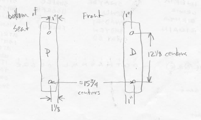

The problem is the mounting holes for bench seat tracks are right over each other (straight up and down), while the bucket seat upper mounting points are offset about 1-5/8" to each side of the floorboard holes:

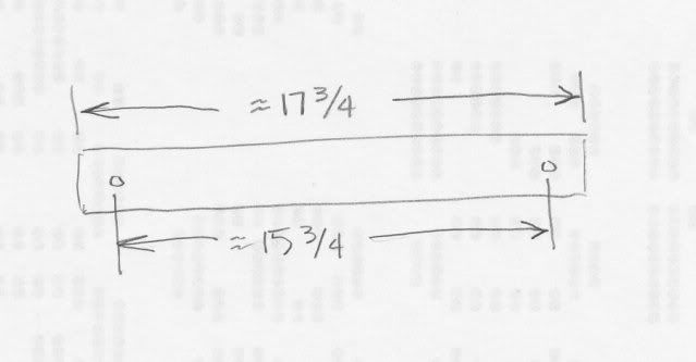

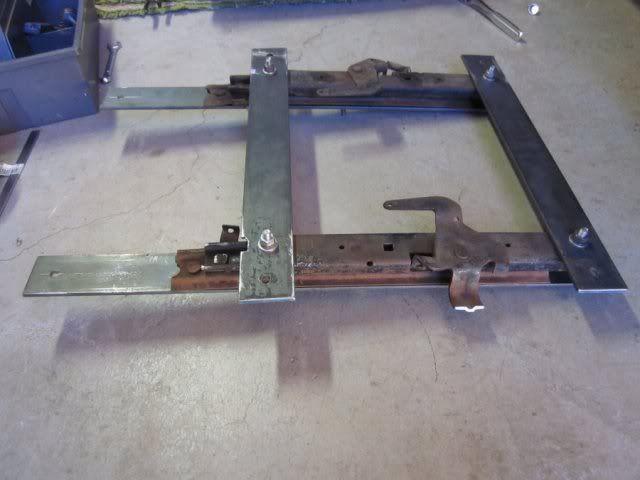

The side-to-side width of the mounting holes in the floor is about 12-1/2". The width of the mounting holes in the seat is about 15-3/4". This will require you to fabricate cross brackets to make up for the 3-1/4" difference in width:
For the cross brackets, cut two pieces to a length of 17-3/4":

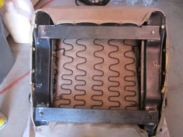

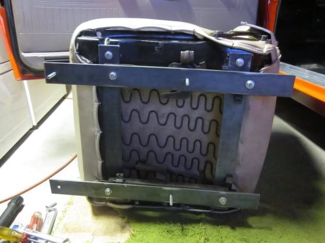

These will mount sideways across the bottom of the seat:
Next, drill the two inside holes in each bracket, which will attach to the seat tracks. I split the difference and drilled the holes exactly in the middle (1-5/8" in from the outside holes). Note I had to notch out a few places on the front bracket, to clear parts of the seat frame:

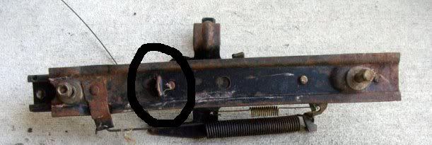

Before re-assembly, a few modifications are needed to the seat tracks. On the bottom of the outside track, I cut off a tab (circled) that was sticking down and didn't seem to be used for anything.

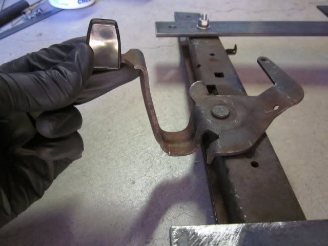

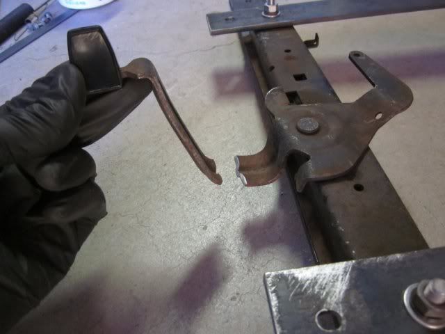

I also cut the adjuster handle, which will not clear the seat if left in its original position. You may be able to bend this out of the way instead of cutting. Now I have to figure out a way to re-attach it when I get time.

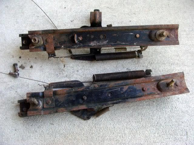

Ordinarily, a wire runs from the driver's side adjuster to an arm on the passenger-side locking tab (see below). The locking tab on my inboard track was not engaging, so I left this wire off (only my outboard track locks). If both of your locks are working, you will need to shorten and connect the wire, or disable the inboard lock.

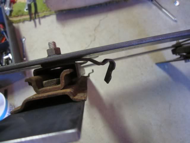

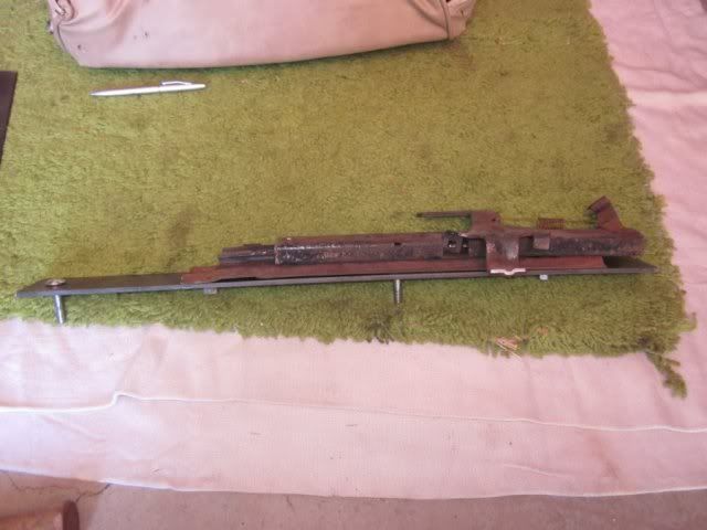

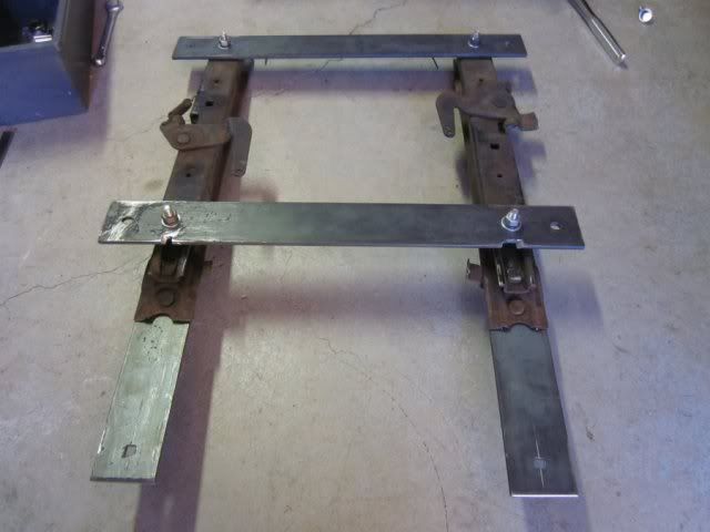

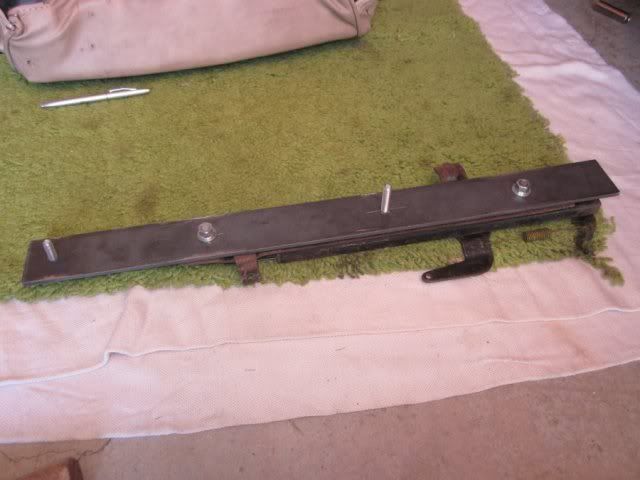

Now it's time to start assembling everything. This must be done before attaching to the seat because the nuts which attach the top of the seat tracks to the cross brackets are inaccessible once the cross brackets are on the seat. Starting with your longitudinal brackets, insert carriage bolts in the square holes, put the seat track studs through the bracket and attach the nuts. Cut off the excess length on each seat track stud, and file smooth.

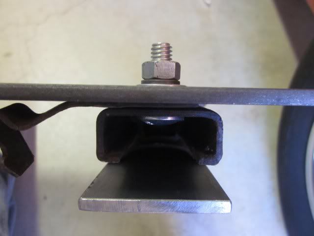

Use short carriage bolts to attach the top of the seat tracks to the cross brackets.
The seat track holes are square, and the low height of the bolt heads will avoid interference with the track mechanism:
You'll have to slightly bend the spring brackets on each seat track, to avoid interference with the cross bracket. You can even cut these off if you're not using the large spring, whose only function seems to be pulling the seat forward when you release the mechanism. The only spring I'm using is the one that holds the locking mechanism in place.
As you can see, overall height of this assembly is only 1-1/2":
A couple views of the completed assembly:

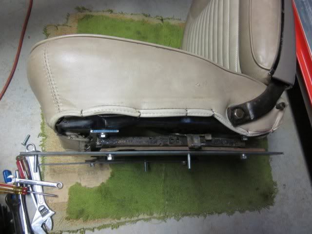

After the seat tracks and four brackets are assembled, bolt the entire assembly to the bottom of the seat. You may have to go back and slightly tweak some holes, enlarging them with a file to get everything to bolt together:
Ready to be installed in the car:
The seat is now so low, there is no longer enough clearance for the seat trim pieces, so I had to leave them off.
