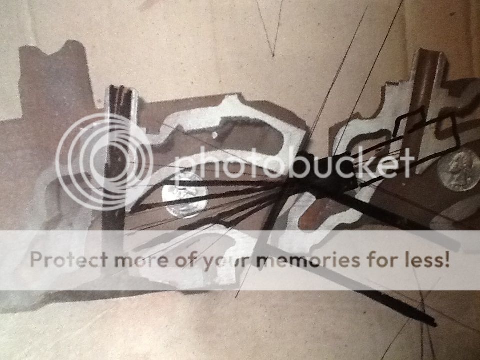

Thanks to Shaker 223 for posting bandsawed head pics.
Since I'm going sequential injection I can try to hit the back of the valves. The Siemens Deka 60# injector has a 26* cone spray pattern and videos I've seen show the diffusion starting a distance from the nozzle (1/2" maybe).
The outermost lines I drew are roughly 26* degrees, the inner pair are probably a better real world representation of what I'll see.
It looks like I may not hit the valve unless air velocity "sweeps" the charge significantly.
The alternative is to back the injector up the runner and fog the head.
Any and all comments are valuable to me.

It seems that either way ill be spraying the runner, so maybe hitting the higher temperature head will be better for atomization.
1960 Seneca 225 turbo soon to be EFI
PostPosted: Wed Dec 12, 2012 4:32 pm
Posts: 13421
Sounds good to me.

Thanks for the article, Tom. I've read it several times and I think I'll have to just plunge in.
If I consider a few phrases in an attempt to identify my application, like:
...Large injectors, over 90#...
...1000 HP motor....
...15000 RPM...
vs
...stocker...
...high idle vacuum...
I'm left with no real clear performance recommendation other than intercept angle and packaging constraints.
So if I endeavor to establish optimum intercept angle the bung moves farther downstream so my rail will comfortably clear the TB.
My hope is that the Deka atomizes well at short duration and or the stream hits hot enough surfaces to meaningfully assist atomization.

Targeting the valve is a good thing, but it's also not something to pull your hair out if there isn't a good way to get the injector to spray onto the valve. Usually the acceleration enrichment tuning can compensate for the extra fuel sticking to the runners or ports.

You are not going to hit the valve anyway as the valve is so deep into the port. I would shoot for a 45 off the intake runner as close to the flange as practical. Makes it EZ to get fuel rail clearance. With the low RPM's we run (compared to F1) and the flexibility of EFI, it can compensate on the fly for slight variations on head temp/ratio/inlet temp. F1 injectors are located right at the ram air horn inlets, 6-8 inches from the valve. Looks like a fog at RPM up there.
