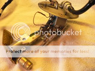

I completed the modification of the Ford fuel pump/sender:
The Ford pump has a crazy little pressure bypass in the line between the pump and bulkhead. Since this pump won't see any real pressure, I got rid of it and used a piece of fuel line. Then I cut the pump bracket and welded it back together at about 6" deep.
Then I cut the pick-up tube from my stock Mopar sender and welded it on to the Ford bracket at a decent angle. I wrapped the sender with a wet rag to protect it from excess heat during welding.
I am using the stock Ford check valve on the return.
When the install is complete I will have an access in the trunk floor to get at this thing. I have full swing on the float arm, but I will have to get used to keeping the fuel level higher, due to the in tank pump and no sump or baffles.

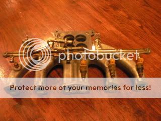

A Ford 4.6 has bore centers similar to ours, so I took a set of fuel rails and cut the end bung off of each. Then I migged a 1/4" stainless pipe nipple between them in the supply to obtain our 2" spacing and a 1/8" SS nipple into the return. I pressure tested by placing #5 rubber stoppers (HomeDepot) into all the open holes and tie wiring them in place. I pressurized the Shrader valve and held it under water. Good to 75 psi.
Cost 12.00. Stock Ford regulator may work with boost ref and pump gas. Anybody have experience with boost referencing this regulator?
Although the bore centers are slightly off, there is plenty of wiggle room in the injector fitment to begin with. If it doesn't work, I'll do it again.
This is good news! Ill be doing this instead of custom fuel rail with 6 holes drilled and fingers crossed for sealing.
