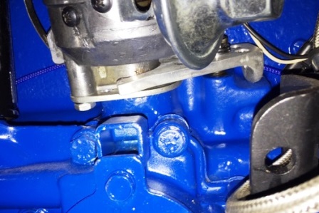

This pic (1979 block) shows the "ledge" that gives the claw leverage for clamping. Without something for the lip of the claw to lever against, it just bolts flat down onto the flat machined block surface (earlier style blocks) and the lip just hangs over the edge without pushing against anything. It will still give some clamping action on earlier blocks, but not nearly as much as on the later blocks. This pic shows an aluminum claw I made from a piece of aluminum angle. It does the job quite well, but was a pain to make.

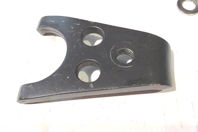

This pic is of the factory claw from my 1979 block (I drilled the extra holes in it).

Hmmmm. I have a hard time believing the block was modified just for the hold down, but those are good pictures. I will investigate further.

I am just showing pics of what I have found out. I have no idea when the claw style mount started, but I believe it was mid to late 70's. The block is indeed different for the claw mount, but I am not saying the claw will not work on earlier blocks, I am saying it doesn't work nearly as well on the blocks without the cast in ledge (or at least a wide enough machined area for the lip of the claw to get leverage). I can post pics later of the claw on a 73 block (without the ledge).
