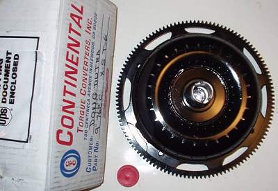

If you are out West, you may want to try Continential Converters.

The converter i got form Continential is a "special order" 8 inch unit, it was kind of "spendy" at $700.00 but it works real good.
I'm sure they have cheaper ones to fit your need so give them a call and get a quote.
