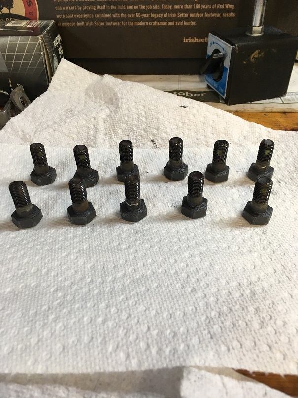

, the existing ring gear bolts /threads looked fine, I cleaned the Loctite off with a wire brush,
re applied blue Loctite to the threads, put a light coat of ARP bolt lube on the under side of the bolt head and re installed

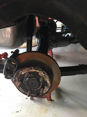

PostPosted: Sun Apr 22, 2018 5:57 am
the rear end is back together,
