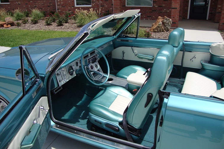

I'm in agreement with both Lou and Reed on basic improvements. I did most of them on my '64 200 convertible, but I went overboard in a few other things.
Not needed, but I replaced the rear end with an A-body 8-3/4, only because I got a great buy on the housing. I also replaced the complete interior with stock colors, but added Chrysler Sebring power bucket seats and a custom built console. Another extravagance for a convertible is the Vintage Air A/C system. The suspension was all upgraded to the V8 parts, including torsion bars. With all the new parts and a Firm Feel stage I power steering box, I can honestly say it's as solid and quiet as a low-mileage late model convertible
My choice for an electronic ignition was the Mopar Performance version, but I replaced the MP orange box with a stock unit for better reliability.
