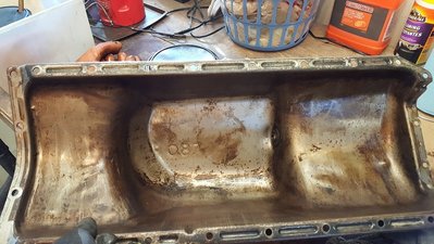

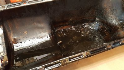

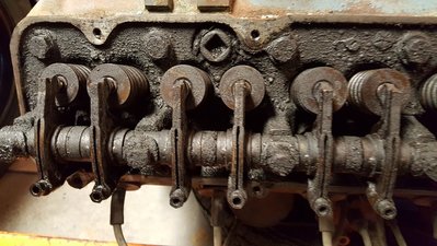

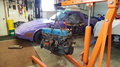

Some pics the 225, and the rockers and oil pan

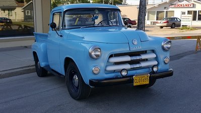

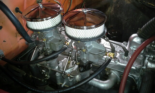

The 55 Fargo and the IND 265 Flattie
