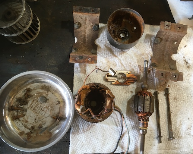

OK. The motor is fully disassembled and soaking. Turns out the jug of environmentally-friendly deruster I had is Metal Rescue, not Evaporust. I bought it in 2012 so my memory was foggy. But they appear to be very similar products, so I am forging ahead. It is supposed to soak at room temp (68 F or higher) for a couple hours, but my garage is about 50 degrees during the day so I will leave the parts in there for a few days.
Here is a picture of the disasembled motor. I tested for resistance and continuity across all the bars of the armature (I hope I am getting the terminology right) and I believe I tested correctly. Testing the commutator bars 180 degrees apart revealed 0.2 ohms on every pair. None of the commutator bars was shorted to the armature. I tested the windings in the housing and none shorted to ground, or to each other, and all showed different resistance readings. I think this means all the windings are OK, the unit just needs to get derusted, lubed, and reassembled. Fingers crossed! Once the parts come out of the bath I will rinse, blow dry, and then cook in the oven for a bit to dry out the windings.
Interestingly, there are no permanent magnets in the motor. It appears the magnetic fields are created by exciting the windings. Of course, I haven't taken any electronics course since high school, and that was 23 years ago now. I vaguely remember something about Mr. Ohm liking square pie, but that's about it. I think I have messed up my old mnemonics.

Posts: 25083
Most small motors like this don't have permanent magnets (or at least didn't back then; maybe some of them are PM type motors now).
