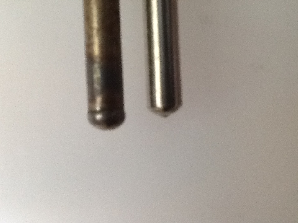

We were so focused on looking at the adjustment screws and the push rod being slightly bent that we overlooked the end of the push rod that goes in the lifter.
Push rod on the left came out of the car and the one on the right is an extra that I had laying around. Obviously this was a bigger culprit on not being able to get the valve lash set.
Should I be concerned about damage to the inside of the lifter?

That worn rod looks to be something different from known Mopar example. Are both the same diameter and length? That end which rides the lifter probably wouldn't move or rotate enough to erode the ball off in a million miles, but I may be off base with this assumption.
You may need to slide off all rockers from shaft keeping them in order of their location, and flush rocker oil passages out with compress air and or solvent or whatever means to allow oil flow to push rod, lifter and valve stem tip.
I did this same project when I first got my Dart, turned out not only was a few rockers blue from heat, but rocker shaft was installed wrong way with oil ports facing away from valve. Once those two details were corrected, oil flowed freely to and through all rockers.

The shape looks bad to me. I would pull the lifter out with a magnetic tool or a long needle nose and replace it with a new lifter. To be safe, you should run the motor for 15 min at 2000+ RPM to break in that lifter. You could do this by going on the hwy (uninterrupted cruise at 45-55 MPH) soon after you put the cover on and start the engine.
Pushrod on the left looks like all the OEM units I have sitting in a bucket on the shelf and the end still looks fine... the one on the right
does no look right even for an after market unit (the smith brothers moly units look like that but the ends look like the stocker on the
left).
I would pull the lifter and inspect as previously suggested.
