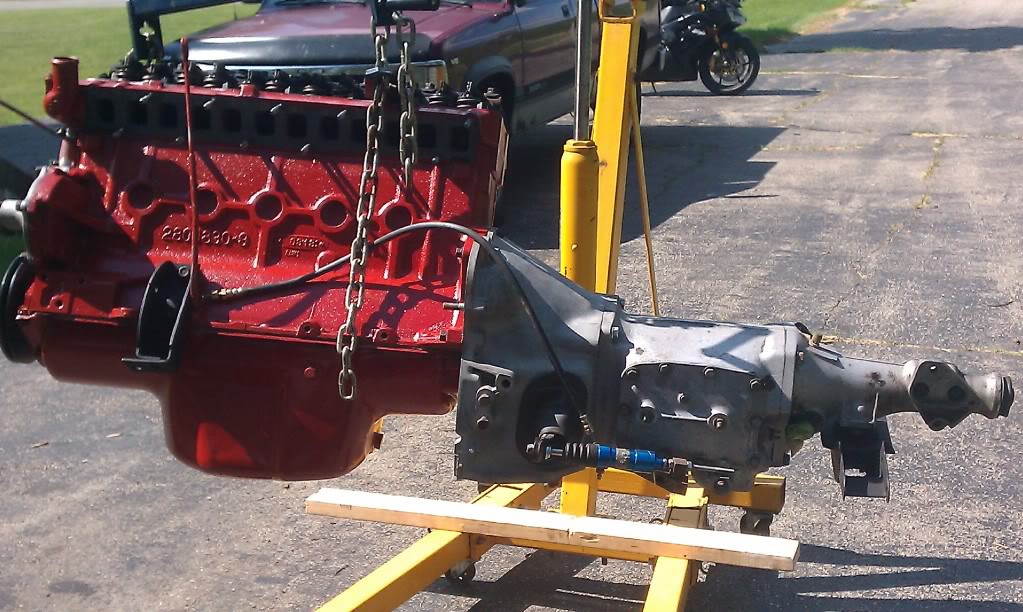

If and I do meannif I pull this project off this car will have a new lease on life, with a decent powerplant.
I have my reservations on this project too.
My biggest hurdle is the clutch throw out.
I may have to resort to an expensive hydraulic release bearing, I'm hoping not.
This could very well be the first 79 RX7 in the world eith a slant 6 and 833..

Anything can be made to work at a certain price.
I have minimal space for the super long throwout fork.
If I can make clearance I should be able to rig up a slave cylinder to work it.
If not a hydraulic throwout bearing will be required.
Going A904 the initial price. A freshen up and shift kit, then a shigter and kick down cable as well a cooler will be needed. So thats not any cheaper than an expensive custom hydraulic setup.
If I cannot get tge clutch working in a budget.

Does anyone know how reliable and well hydraulic release bearings do work?
How about this setup would this work?

The Tilton hydraulic release bearing has great reviews.
Im fighting for every bit of space in this area for the throw out fork etc.
Like to here from those who have these type of release bearing setups.
As this car is already set up for a hydraulic clutch it makes things a bit less complicated.
