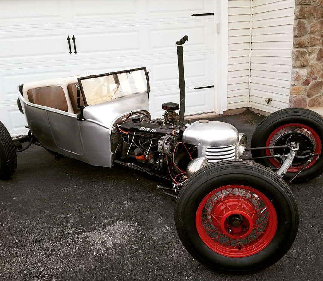

PostPosted: Tue Jul 17, 2018 8:18 am
Posts: 183
Location: Southern MD
Here is the best photo i have right now. I am planning on running Dutra duals and run the exhaust along the drivers side of the car.
PostPosted: Tue Jul 17, 2018 9:16 am
Posts: 399
Location: Pauls Valley, OK
Car Model: 1975 Dodge D100
Cool ride, man! I bet that's a real attention-getter!
Welcome! You'll find that it's a good place to be.
PostPosted: Tue Jul 17, 2018 10:44 am
Posts: 17645
Very cool! Sounds like a good plan w/exhaust. Hope you can join us at Mason Dixon Dragway in October, even if you just want to come and hang out and meet everyone.
