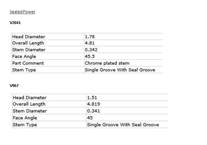

PostPosted: Mon Aug 06, 2018 10:16 am
Posts: 1450
I have used these Sealed Power valves. They are originally for some various ford applications.
They will require new valve guides.
jus' sayin'
PostPosted: Mon Aug 06, 2018 10:57 am
Posts: 1473
Location: North Georgia
jus' sayin'
That's good to know! Did you have to use different springs, etc.? Seems like those would be a good fit. I need valve guides regardless of what I do, so that's no problem.
PostPosted: Mon Aug 06, 2018 12:42 pm
Posts: 1450
I just had to get new keepers and retainers. I could probably have gotten by with my original retainers. I used the HP 340 valve springs.
-Matt
