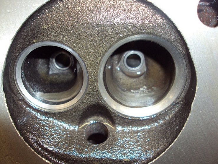

Couldn't resist doing a little bowl blending while things were apart. Valves back cut 25*.

Bolted the head on today, along with the valve train. Keep in mind this is a 74 225 so it has solid lifters and adjustable rocker arms. With .090" cut off the head I did not need to buy shorter pushrods. Valves adjusted as normal ( in. .011" and ex. .022" ). Cup end of pushrods was closer to the rockers, but still had about .035" cup to rocker clearance at max lift - Running a stock cam. Not ideal, but rockers still sweep the valve stems ok, so I am gonna run it. Running a after market cam with more lift and or hydraulic lifters might need shorter pushrods? Anxious to fire it up, but still have some assemble work and exhaust modifications ahead of me.

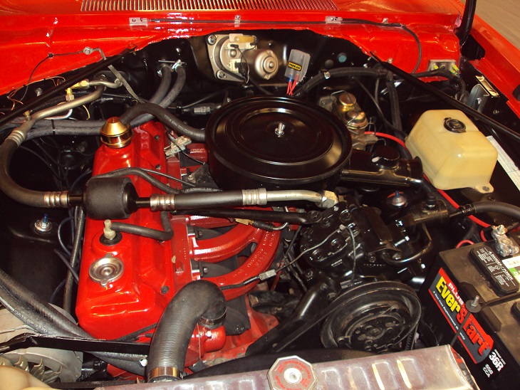

All back together. Runs real good - and on all 6 cylinders. :D I will get a few miles on it before I run a comp. test and check the valve adjustment. Seems to like a lot of lead. Running 10* BTDC ( on a stock electronic dist. ) now and might try a little more. Until I can put it on a dist. machine, I don't know what the stock curve looks like, or how much advance is in it? Running ported vacuum on the vacuum can. Might try manifold vacuum for grins. Again, not sure how much is in it. I can get away with murder up here at 5000 ft above sea level and 7.8:1 CR. :) I can now probably put the hurts to my Buddies Prius. :mrgreen:
