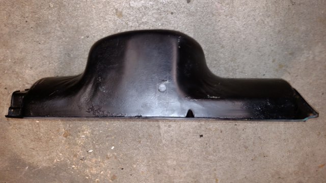

Got to try out my new step drill.
Found a good weld on fitting, the step fit tight in the hole and made welding set up easy.[attachment=0]

Yes worked out good. Fit tight I dont even think Ill weld the outside. Maybe some JB weld.

It was cheap to, $8.99 for 2 with free shipping. Tried to get it near the main but ended up at the counterweight. .....

The oil just dribbles out so I would not (and did not) worry about location near counterweight or whatever else.
